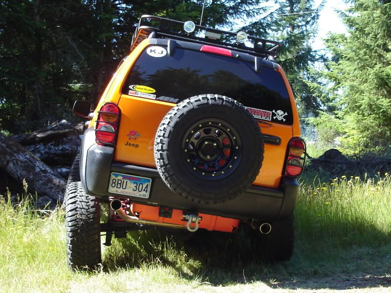

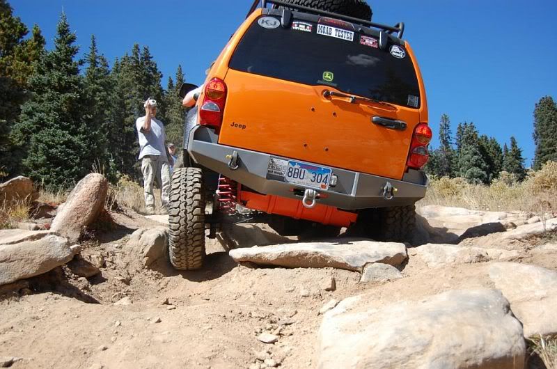

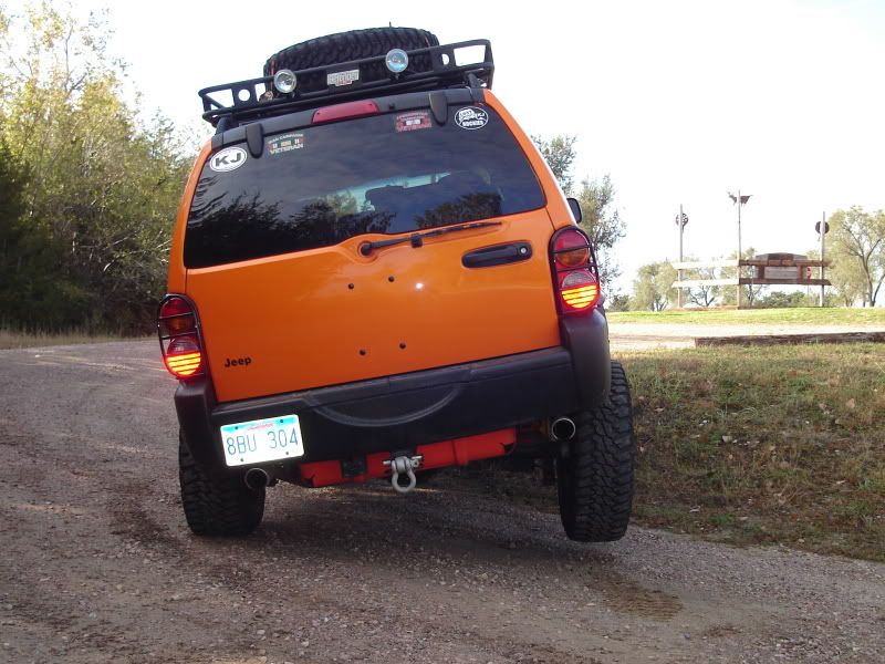

PostPosted: Mon Dec 08, 2008 11:14 pm
dieselenthusiast wrote:
You also may want to compare the length and full extension of each shock.
SkyJacker Nitro's,for KJ with 2.5" lift...............
OME N132's..............
Rancho 17004's,now you got to take into account I have the RL bumber on in this photo.

the skyjackers and the ranchos look like they are pretty close to same
