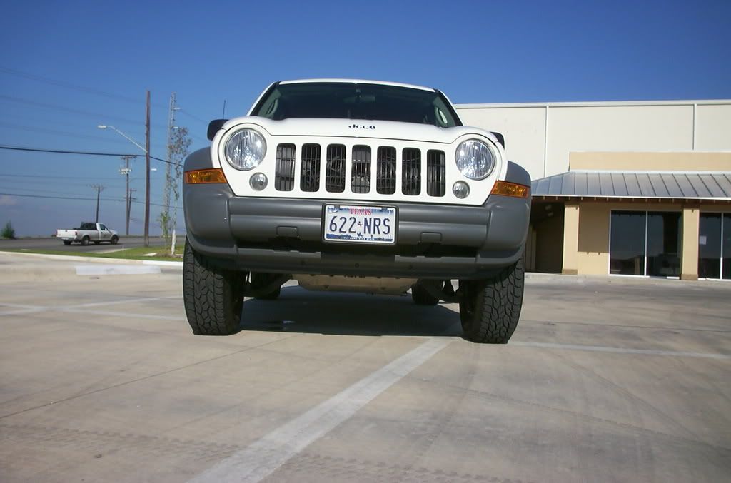

PostPosted: Mon Jan 05, 2009 3:12 pm
Posts: 1118
Location: DFW, TX
I love my Daystar lift too. Just had it for a couple months, but I wouldn't change it if I had to do over again. Suits my needs just right.
