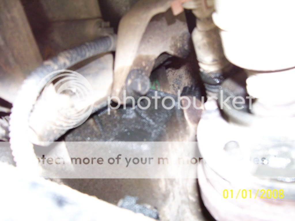

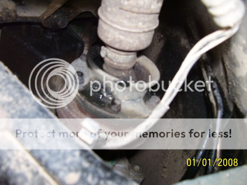

PostPosted: Wed Apr 29, 2009 11:04 pm
Posts: 1244
Location: SARANAC, MI
This Is what i've found.

PostPosted: Wed Apr 29, 2009 11:06 pm
can't see if the boot is gone or not from the pictures but it appears it is from the grease
PostPosted: Wed Apr 29, 2009 11:09 pm
Posts: 1244
The boot is there. If I pull the bolts the go around that knuckle can i re pack it and maybe regain some life. This thing only has 40k on it and only been lightly wheeled nothing major yet. except one accident in a deeper than expected water hole. that don't count

PostPosted: Wed Apr 29, 2009 11:20 pm
Only in a Jeep!
Only in a Jeep!
Posts: 3966
mine was clean , not throwing grease, no noise at all ...yet, so if someone would not have made me crawl under....... :wink:
:lol: Did I do that!? :wink:
2000 Cherokee Trail Hawk
can't repack it, grease will just be thrown back out, part of the boot may still be in there, but with the way its already thrown grease out its done for more than likely
pull it out and run it. Chris did for a while, Tbird and I both are now
