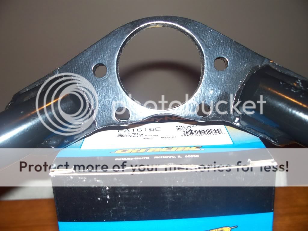

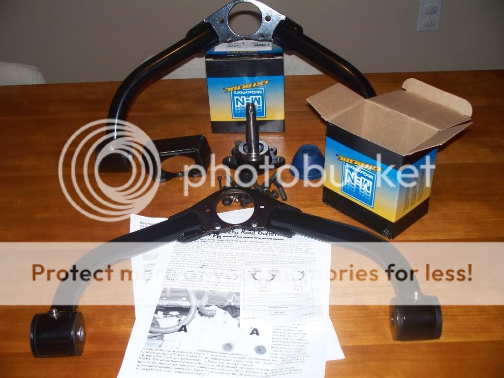

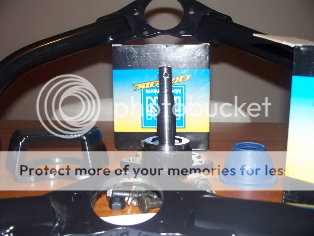

UPS arrived with a package from RRO today as expected. Everything was well secured & packaged nicely. Let me start by saying these Insane A-arms are Insanely beefy & seem to be well made. The welds look very professional. I must say that I am very satisfied with my purchase. Pictures to be posted soon...

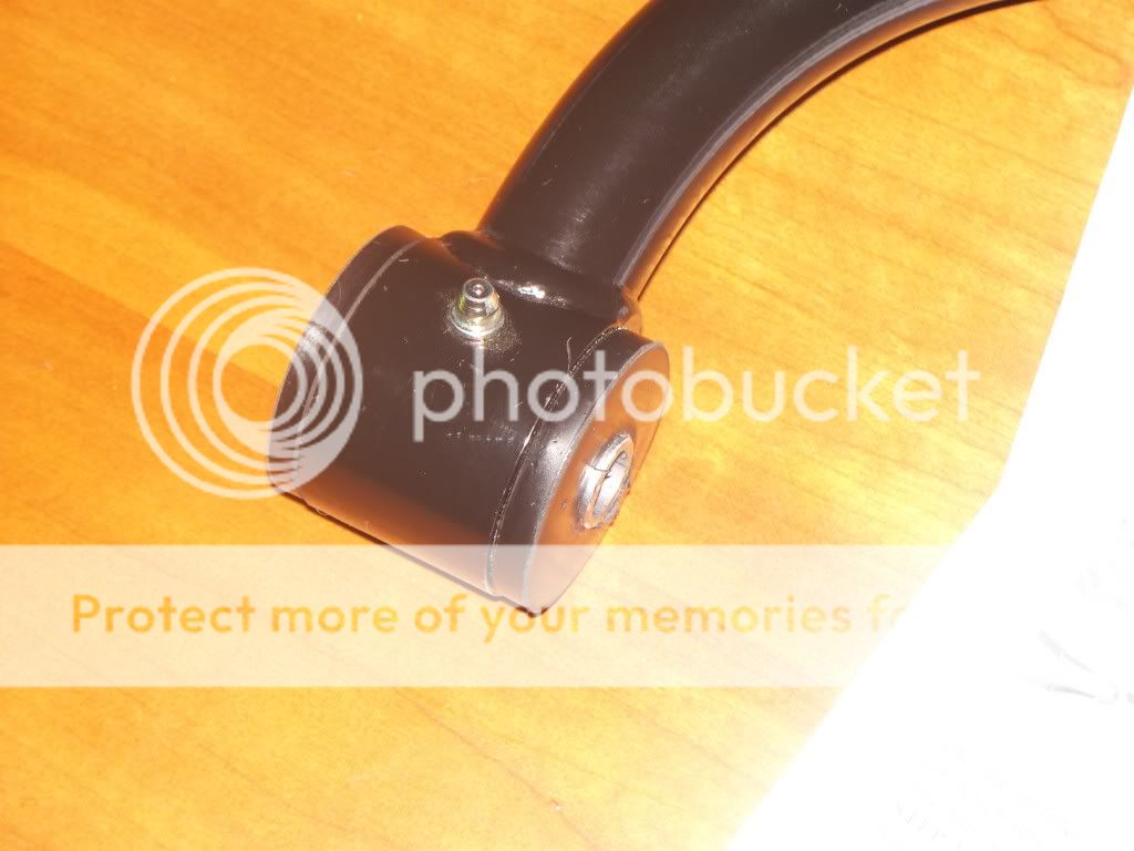

Upon further inspection of The RRO Insane Aarms, I found that I am missing a metal sleeve that goes into the bushing. I double checked the box & nothing. Im thinking it failed to be installed during manufactoring of the product. A email followed by a phone call to customer service is on the to do list for tomorow. Install date is being pushed to a later date. Pictures to be posted soon...

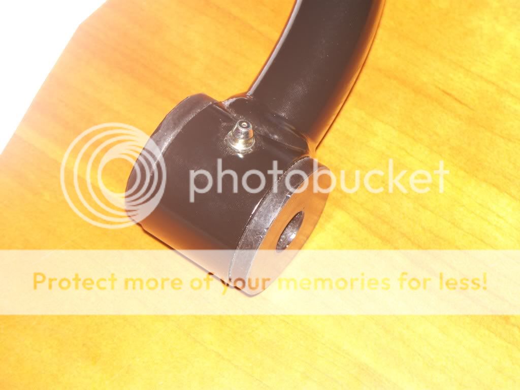

3 grease points also. Does Al's A-arms have those extra grease fittings?
No :shock: Those are really nice! Al's only has the grease points on the ball joint. And it has a housing for the ball joint. So it doesn't get smashed maybe? Also, I'm no expert, but that looks like it has way thicker (better) welds.
So let me get this straight...three grease fittings, instead of one, protection for the ball joint, stronger welds, and their cheaper??? I think we may have a new winner.

PostPosted: Sun Jul 12, 2009 1:43 pm
Rudy wrote:
stronger welds? Don't see it, I would still rather pay more for someone who stands behind their product no matter what, but time will tell how this all works out, hopefully it does for those that think its a better deal.

PostPosted: Sun Jul 12, 2009 4:57 pm
The addition of the zerks to the bushings isn't really going to make them last longer, if any thing, it will make it wear out faster. they are going to attract dirt like mad. There is a reason why you grease heavy equipment after 10 hours, it's to push all of the dirt out of the bores and pins.
