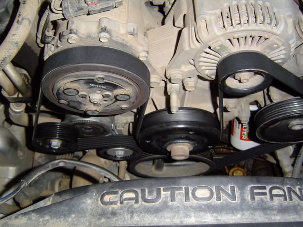

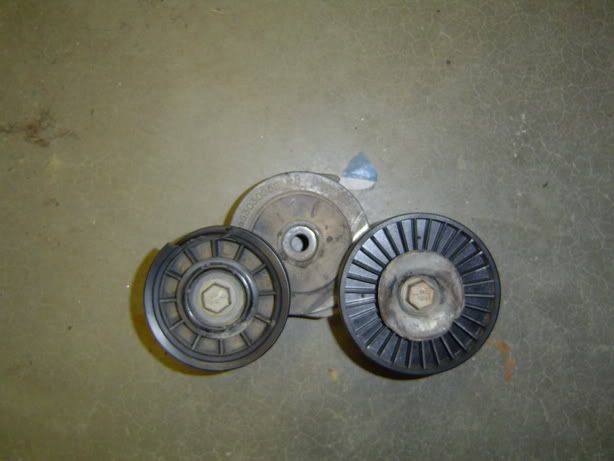

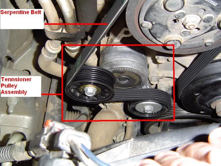

PostPosted: Wed Jan 04, 2006 12:36 am
Posts: 1339
Location: Richmond, Virginia
Ok here you go: A view of the Tennsioner Pulley Assembly and Serpentine Belt inside the engine bay:
A view of the Tennsioner Pulley Assembly (Note: 1 of the Pulleys is broken thats why I replaced the assembly):
And another view of the serpentine belt assembly from the engine bay:
Hope this helps you out!
