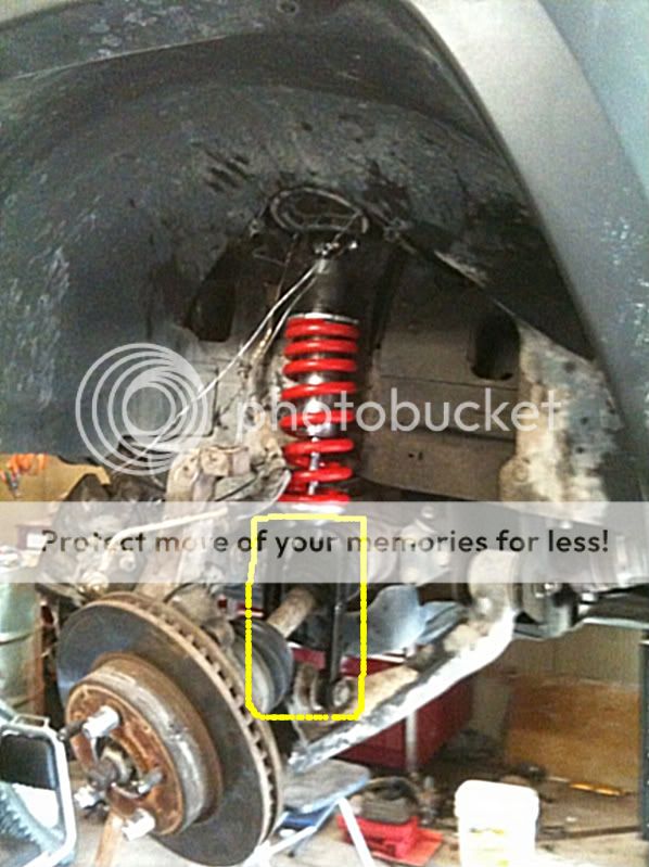

Front disassembly went smooth; the stock stuff was so shot that it offered little to no resistance when we pulled it out. I don't have a lot of pictures of the front because I was concentrating more on the install, and basically forgot to take step-by-step pics.
We started the front install on the driver's side, since it is the most difficult. With the old A-Arms out, we tried to place the new driver's side tower in and ran into the second snag: the strut tower comes preassembled and preset for height, and it was simply too long to cram in the space. We removed the top-plate from the strut tower, installed it in the subframe, and then were able to get the tower in and attach it to the strut plate.
Third snag: the tower was simply too long to mate up to the lower clevis bracket without compressing the strut. Since I had asked - and been assured - that no spring compressor was necessary, we were at a loss. After disconnecting the front swaybar and trying it that, way, we briefly considered disconnecting the lower A-Arm from the lower ball joint to drop it enough to attach the lower clevis. Due to the myriad of things that could go wrong there, we threw in the towel and went and rented a spring compressor.
Long story short, the space between the strut and the coil is too narrow to get a good seat with the compressor, so that didn't work. Then Lee's buddy Fred had the brilliant idea of raising the adjustment collars as high up as possible, then seeing if we could use a prybar in the clevis to compress the assembly enough to bolt in. It worked! When you screw the adjustment rings up about 1.5 inches, the coil is then hand-loose on the tower. So, we used the prybar braced against the lower A-Arm bracket, Fred muscled it into place, and we ran the bolt home and impacted that sucker before it could protest. I wish I had had instructions that told me that. . . . :roll:
After installing the JBA UCA on the driver's side (always a breeze, :lol: ) and bolting everything back together, we moved on to the passenger side and repeated what we learned on the driver's side. It went much easier, since we now knew what we were doing. Starting the passenger side, we were about 8 hours into the lift.
Note the "KJ" in the passenger side clevis - a nice touch, IMHO. . .
. . . and the difference between the passenger-side clevis and the driver's side clevis, due to the tighter CV angle of the CRD.

Location: Hawaii
Any update on the lift? Hows the ride offroad, how about the short driver's CV angle, and problems there yet?
Could you have gone up to JBA's 4"?

I know its too late now and you installed it 8 months ago, but all you had to do was loosen the cam bolts on the lca's to get more droop to fit those Badarse coilovers in there. :dizzy:
2010 KK 4WD BRILLIANT BLACK
ATHFAB.com
 Post subject: Re: JBA A-A-T Lift Install epic WITH PICS
PostPosted: Sat Feb 26, 2011 9:21 pm
shouldn't have to loosen the cam bolts at all
I think he did it to help installation but he could of ran the coil down some ( to shorten the shock give more play) and it would of went in, much the same as doing any lift with extras
