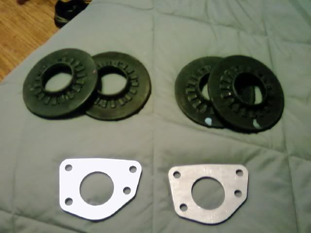

at least you can sell the daystar later, however mind your expendables, if you get replacement stock coils to replace sagged coils, you're halfway money wise to real lift coils and they won't be worth much after 20-30k
Boiler (chip) makes upper strut shims in two different thicknesses for like 45 dollars a pair or so, and conduit nuts will lift the clevis for a dollar plus some electrical tape and you can get an inch out of those two easily for the front and both techniques are useful even with true lift coils such as OME, so they aren't expendables nor are they wear parts and you can get an inch to 3/4" in the rear by adding two extra upper iso's per side for a total of about 50 dollars, again, useful as well with OME type coils so not an expendable
Just a thought if you're trying to reduce your expendables in lieu of having money for the bigger stuff

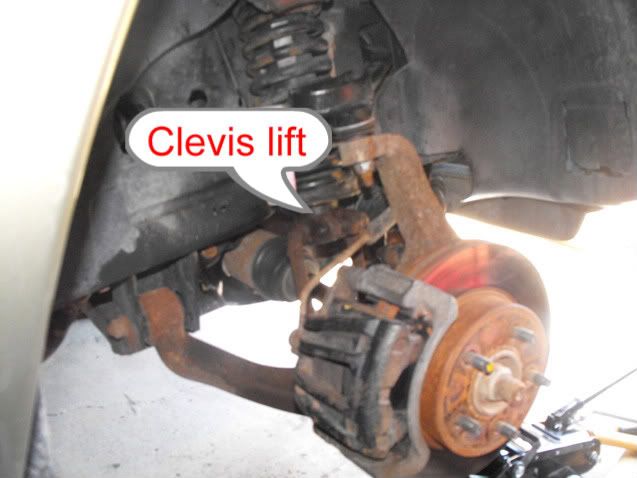

So you think skip the Daystar and do the Boiler shims/clevis for the front and the upper isolators in back(WesWay Lift) for under $100 would be a good way to go? I read a great how to on jeepkj.com. Looks a lot easier than the Daystar and no coils to compress either!
Are the WesWay and Daystar comparable in height?

There's less strain on the rear coils when using pucks than there is in the front so it doesn't cause pre-mature coil degradation
not sure what the height on that WesWay puck is for the rear, pretty sure I've seen it but I can't accurately say
but yes, that's the route i would personally go since it's acquiring items that can be and more than likely will be used again / in conjunction with lift coils at a later date and will lift the vehicle without causing any adverse coil performance other than what you may or may not already be experiencing with the stock coils

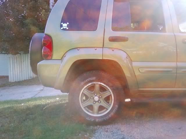

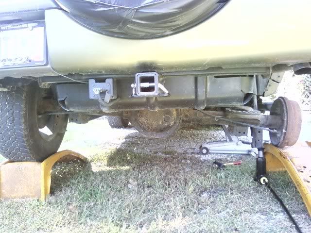

Changed the oil today and got a wild hair to try to put on the rear lift....with success!! I didn't have jack stands, but I used ramps and a couple jacks to get the axle to drop enough to pull out the spring. Worked pretty good so far. I even drove to KCI and back. Cara can notice the difference. I ran out of day light and time before I could snap to many pics. Also gotta measure tomorrow. I'm so proud of myself, now to tackle the front sometime.
Before lift, only pic I could find. I forgot to clicky clicky. :oops:
After lift

 Post subject: Re: Wanted to say thanks.
PostPosted: Fri Oct 15, 2010 12:43 am
looks like a lifted scale model to me ;)
tire clearance is about right with that size tire and the extra clearance, later on, you can add coils, adding more clearance and shove bigger tires in closing the gap
glad ya got it together and indeed there's much less to those additions than the front coil R&R hehe

as long as you don't plan on overdoing the tire size for the increased amount of clearance the only thing holding you back is actually doing it ;)

Might of been easier if I had jack stands. But the ramps worked fine for holding the axle while I used the jack to make it flex a bit more to get the spring back in after installing the isolators.

Oh and I used the Jeep jack that was under my seat. Worked pretty awesome if you ask me!

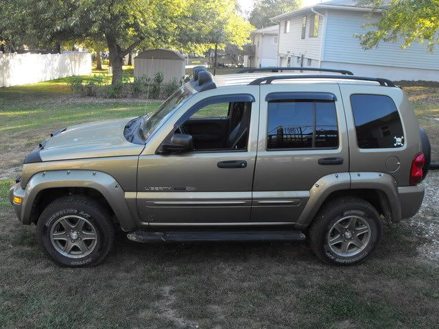

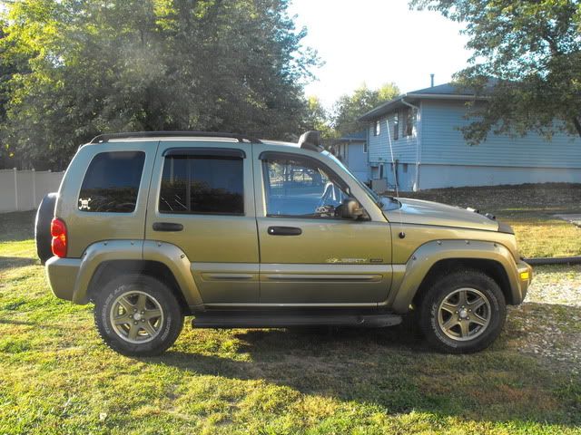

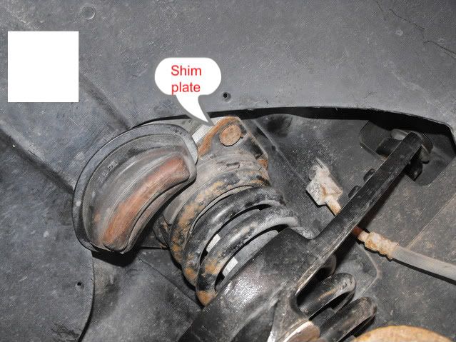

Finished up my lift today with help from my Jeep club President and my Dad. Couldn't have got anything done w/o them! :D Just had a little trouble with the sway bar bolt and the bolt holding the lower control arm to the clevis. Thanks Missouri salt! Other than that just a little messing around to get parts out and back in.
Rear was already done in these pics
Lift complete!
So far I love it. Perfect lift for me. Not much taller but enough to notice when looking at it and getting in an out of it!
