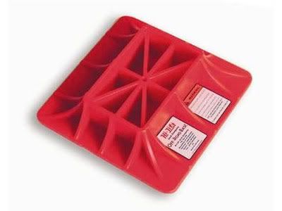

Location: Arlington Heights, IL
I just use the stock scissor jack. I bought just the "Offroad Base" from Hi-Lift, which is basically just a 4" riser, I can place the stock scissor jack on that - works fine. A couple of 2x6 would also work as a riser base, and I think AEV makes a riser base for the JK Wrangler scissor jack (not sure if that would fit a KJ jack but it looks like it).
Not a solution for using a Hi-Lift jack, but you can still use a stock jack with a lifted KJ.

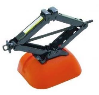

Hi-Lift Offroad Base:
AEV JK Jack Base:
Here are links to Northridge 4x4. :google: around to find them a bunch cheaper, I was able to get the Hi-Lift one from Amazon. Also, not sure as to the AEV one, it looks like it should work but is also meant to fit in the jack storage compartment of a JK. The Hi-Lift one works great.
http://www.northridge4x4.com/proddetail.php?prod=HL-ORB
http://www.northridge4x4.com/proddetail.php?prod=AEV-40306002AA
2003 KJ Freedom Edition, Frankenlift II, JBA modified CV axles, 245 70 17 Goodyear MTR Kevlar
