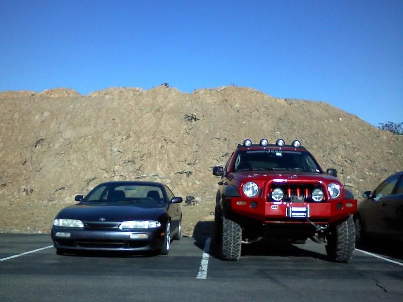

went for LINE X
not cheap, but it's done

NCC,
Love your rig man! :JEEPIN: Your kj is exactly the setup i want to go for with mine. What kinda lift are you running with?
