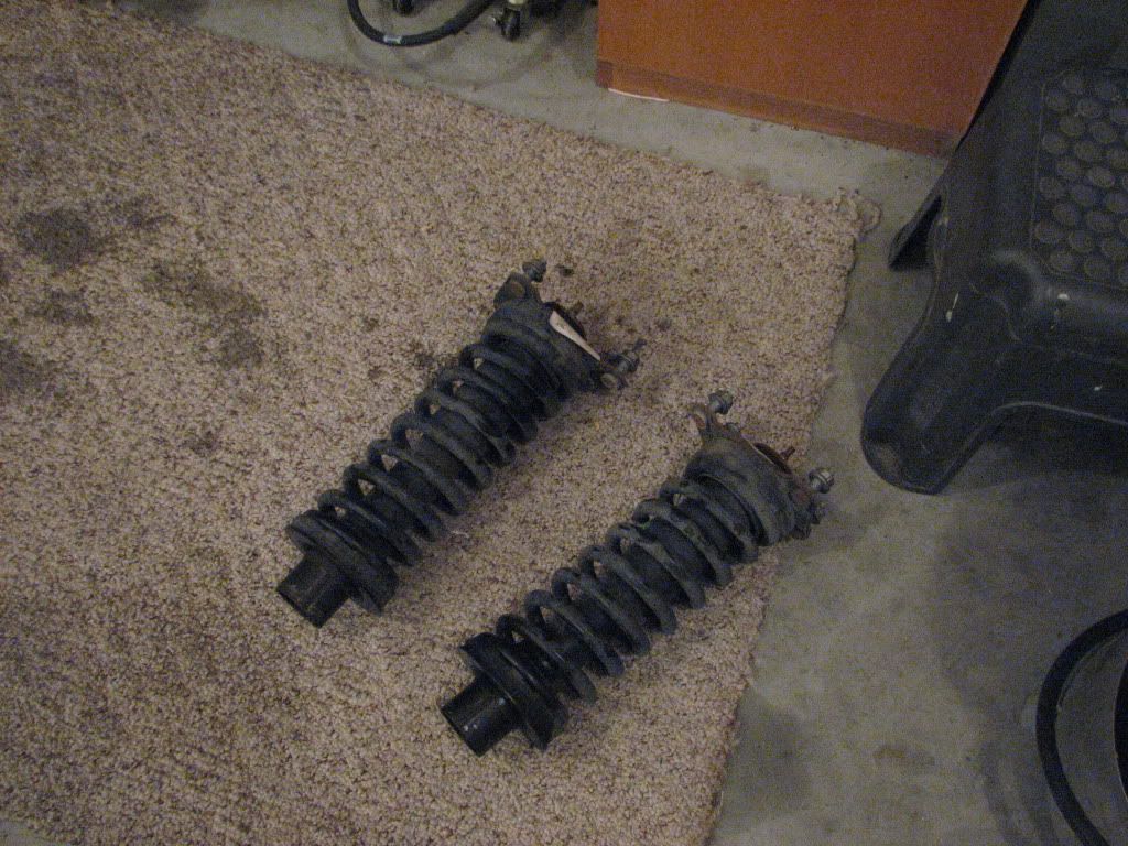

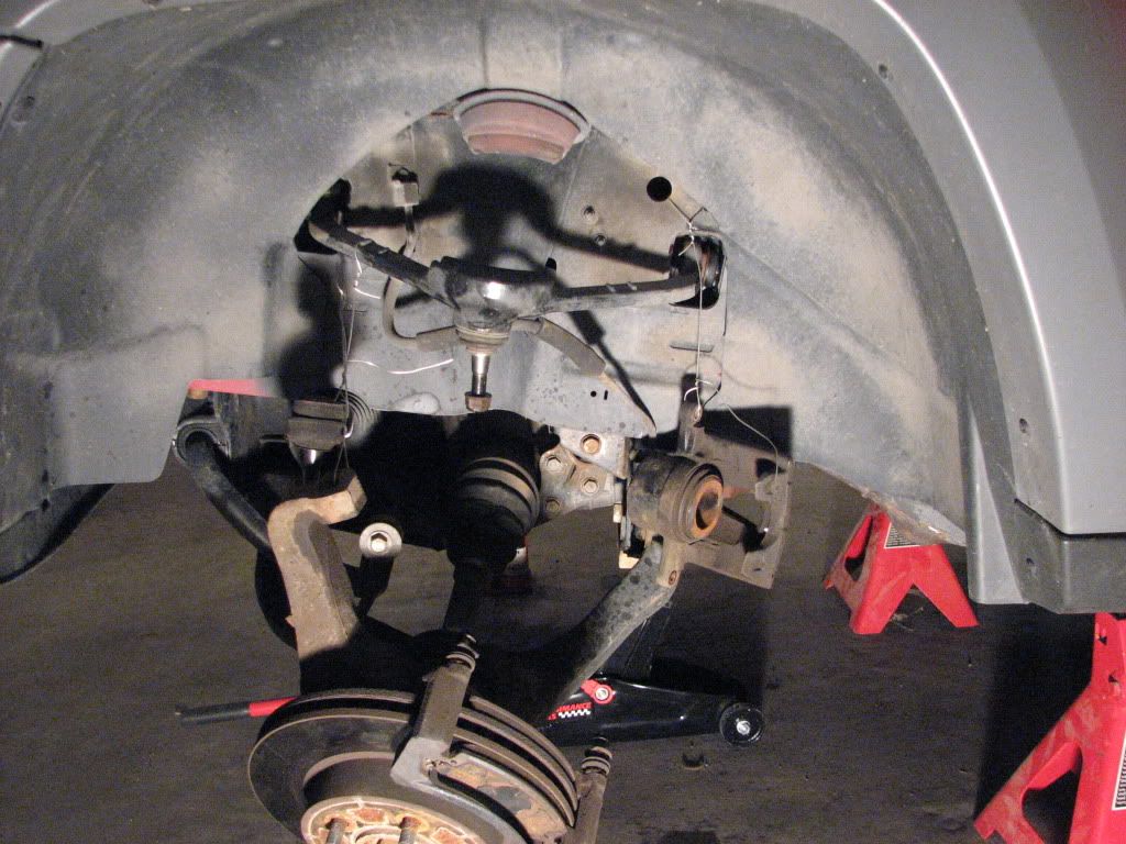

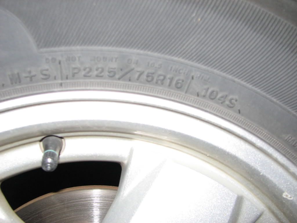

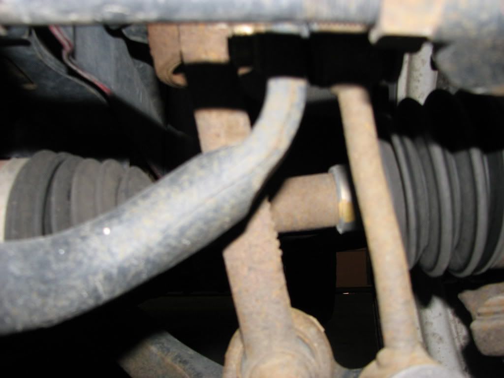

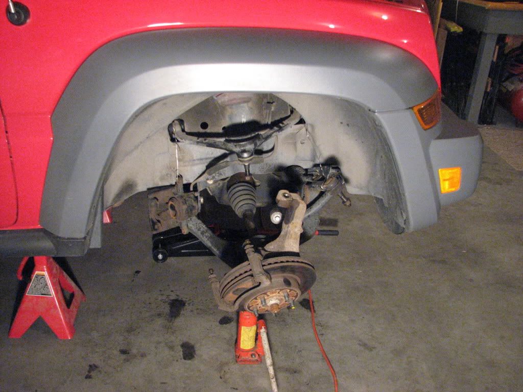

I didn't have much going on so I decided to start removing the stock suspension. My plan is to also put on Goodyear DuraTrac 245/75/16 on the stock rims. I have read a lot of information posted here that made my decision on what lift to buy a lot easier. Here are a few pics from stock setup. As you can see the front end is sagging pretty good.
Shaft angle passenger side.
Shaft angle drivers side
Tires that were on the KJ when I bought it 225/75/16
Passenger side before lift
Drivers side before lift
Drivers side strut removed
Passenger side strut removed
Stock springs and struts
The lift will be here in 6 days. I will post some pictures when I get the lift installed and tires on. Thanks to all of you that posted your experiences with lift tare down and install.

 Post subject: Re: Ordered Frankenlift II for my 2005 KJ yesterday
PostPosted: Fri Apr 22, 2011 9:18 am
You removed the lower control arms to install the lift?
or??
By the way welcome to LOST
PostPosted: Fri Apr 22, 2011 11:08 am
Joined: Wed Jan 13, 2010 5:14 am
Posts: 7
Location: Nebraska
No, the lower control arms are still on. Looking at the pictures might be deceiving because of where I tied up the brake calipers. Thanks for the welcome.

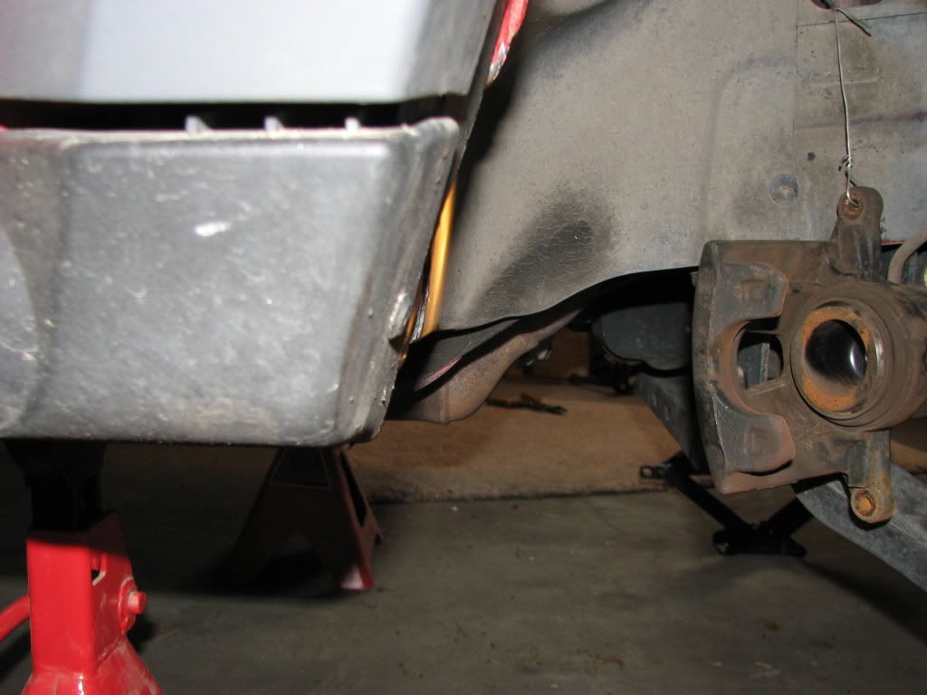

ahaaa, you had a lowrider just like I did before March 18th!!!!
while yer waiting for it to arrive...might as well start pounding that pinch weld over for those new sized tires. :lol:
Do you have any pictures of the pinch weld before and after? I have never had to do this modification before. Thanks.
2005 KJ 3.7
Frankenlift II
245/75/16 Dura Trac
PostPosted: Tue Apr 26, 2011 4:24 pm
Posts: 7
Location: Nebraska
jrs05kj wrote:
Never mind, I found a post that explained it.
Is this what it should look like? Before the BFH?
After BFH?
I don't have any time to fix the plastic right now, but I will after the lift and tires.
2005 KJ 3.7
Frankenlift II
245/75/16 Dura Trac
PostPosted: Tue Apr 26, 2011 4:54 pm
Joined: Tue Jan 25, 2011 4:37 am
Posts: 40
Location: Decatur, TX
Yep
