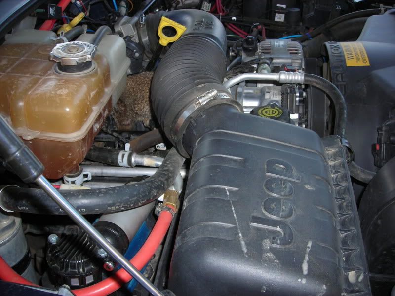

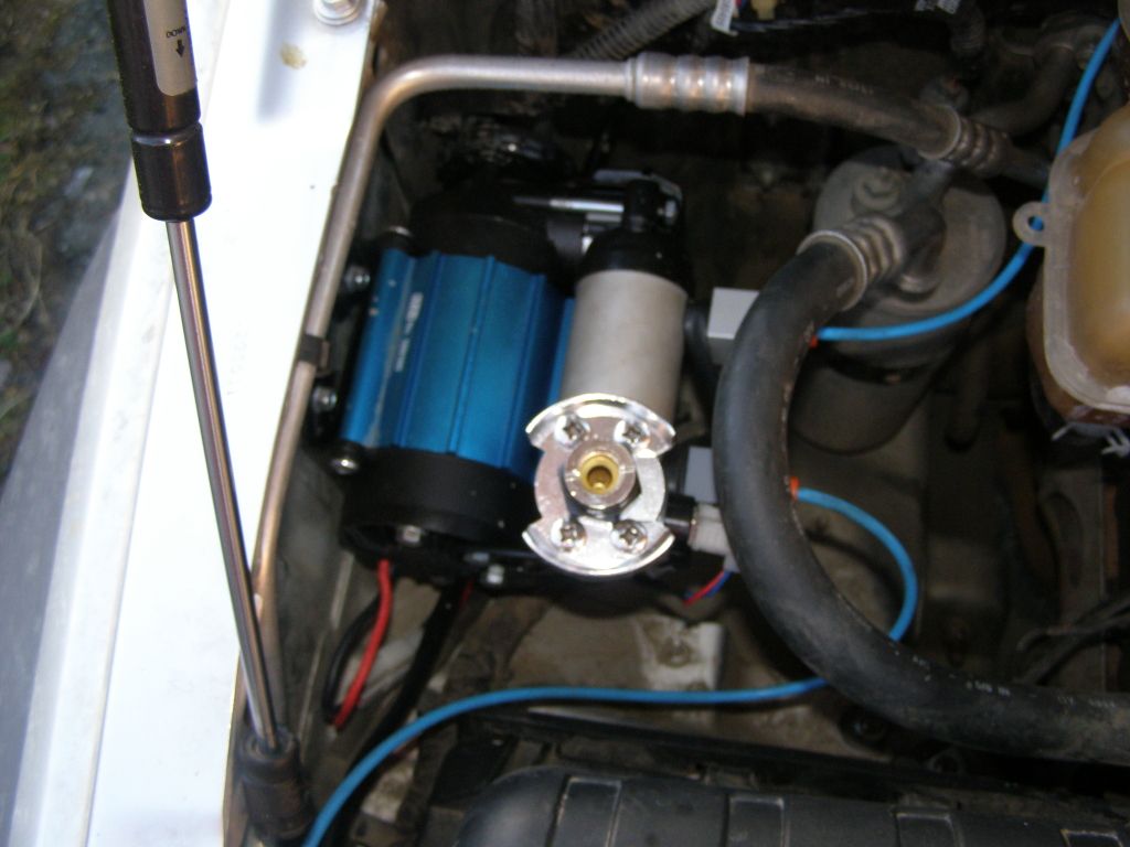

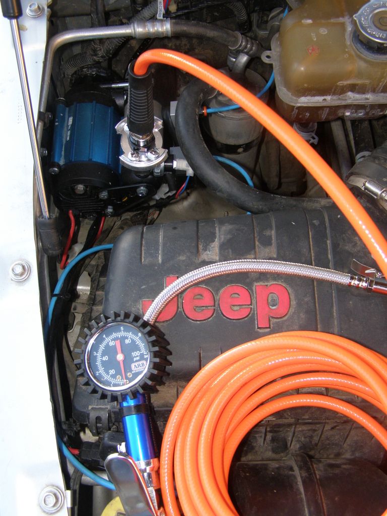

I mounted mine right next to where the squirrel sleeps:
What? The?

Ok, is the critter for the new hybid engine or for lunch later? :ROTFL:

he replaced my lizard.... :juggle:
