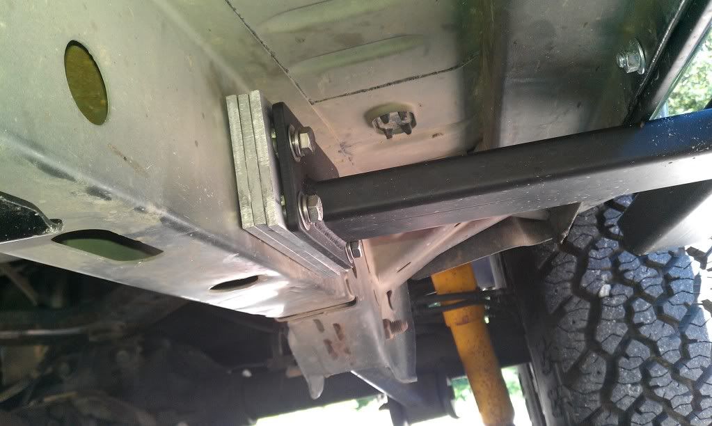

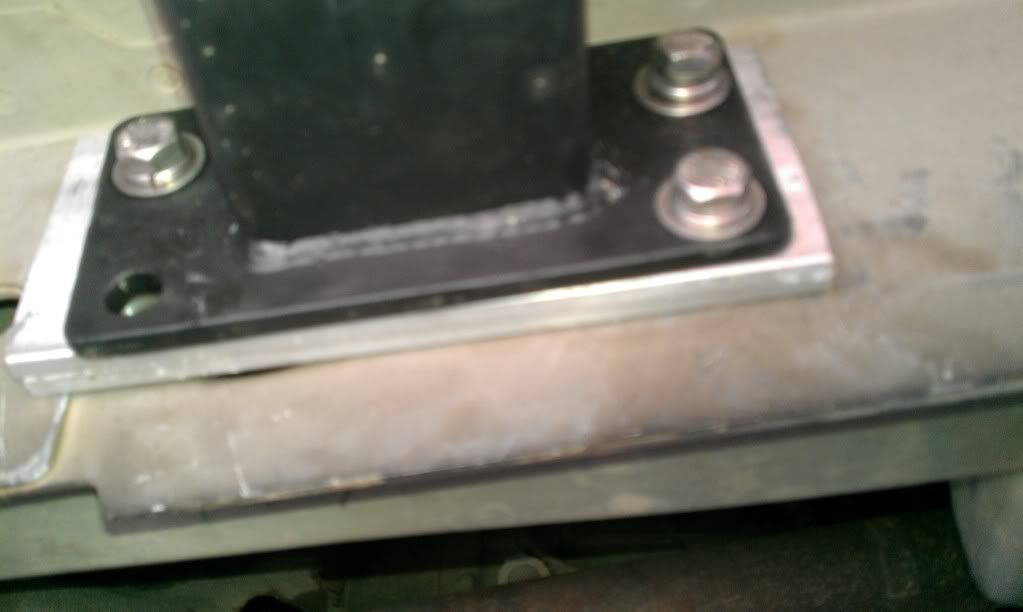

fitment issues is the one bolt hole hits right where there is a hole in the frame so on one set we didn't install a bolt there, other set we installed a pc of metal behind and slid it into the frame
other than that there are no other issues

that being shown, they are still solid as hell, and i should have put the pinch on the inside of the seam, but it wouldnt of made much of a difference at all. they look good and hold up, although i havent had them holding the weight of the car.. yet

Same fitment issue as tommudd. I have hit them pretty hard and they only got scratched.

When mounted properly (irollgen4s has them on the wrong side of the pinch weld) there is only a minor issue with one hole on each side which is easily fixed. They are very well built and are extremely strong. :JEEPIN:

believe me, we tried every possible kind of mounting tactic prior to drilling any holes. we tried for an hour. putting them on the inside would have given us 1/8th and inch, and we needs 3/4s in the rear and 1/2 in front... substantial amount of steel missing there. so we decided to mount them on the outside so we could just make 1/4inch plate of aluminum in increments to fill in the gaps.

You should have bolted them to the subframe first then draw the pinch weld to the mount on the rails. If there was still a major gap then I would have sent them pics mounted properly and gotten a new set made if made incorrectly. They are great to deal with. The plates you have in there make a weak point in the mount and will not stand up to extreme use like dropping off onto a rock or log. But if your happy with them with the way they are, enough said.
