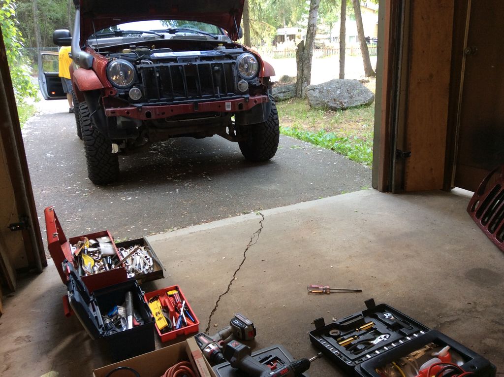

I have 2.75" in the front and 2.5" in the rear.
Achieved with OME 1.5" Lift kit.
Half inch Clovis spacer and 1/4 strut top plate spacer with 2 additional rear upper iso's in the rear for a total of 3 per side.
I have 31X10.5R15 duratracs on 15x7 with 4" of backspacing.
You'll have to delete the pinch weld and wheel well liner in the front a little bit.
Some photos for reference.
OME 2.75" lift. JBA UCA's.
Flowmaster super 44.
BoulderBars. Home built stubby.
31X10.5 Duratracs
Yukon / Motive Gear 4.10's
Aussie Locker. Safari Snorkel.
ARB Diff Guard
Soft 8 - X7 - 4" BS

Looks the goods. Love the look of these things with decent tyres.
How much plastic did you chop from ware? I trimmed a little bit but worried it won't be enough under compression, also, have you done anything with your front bump stops?
You also have to trim quite a bit of wheel well liner with my tire size.
Even with appropriate backspacing. Upon full lock in drive or reverse 31X10.5's will grind and pull your liner out even driving on level ground.
