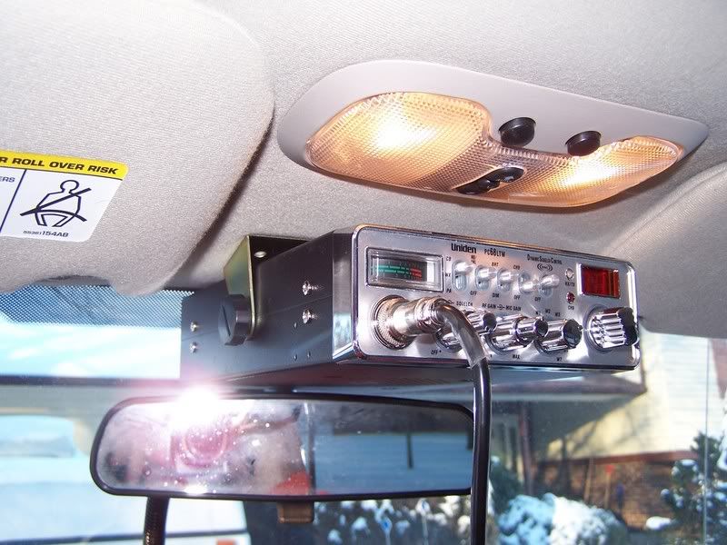

above the rear view mirror -

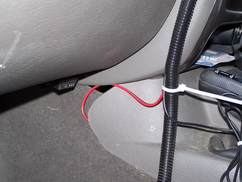

If you pull down on the overhead light it comes out easy. feel against the roof to the front - you will notice a support. You can have someone hold the bracket in place and use a hat pin to push through and make sure your holes are going to line up one the support bar. then mark with pencil. drill pilot holes (you may need to drill new holes in the CB mounting bracket first if you have problems getting the hat pin to hit well). use a self taping sheet metal screw - about 3/4" or 1" - i can't remember which; you are not torquing it down, just tightening the bracket to the roof fabric. run the power down the left side of the center and tie into cigarette lighter line behind faceplate. get some 1/2" flexible conduit and put the coax and the power into it, and down the dash. w3csx may have a picture or two of his. i'll try to one of mine soon.

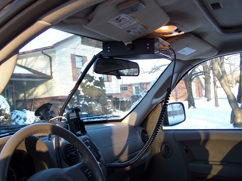

PostPosted: Sun Feb 11, 2007 12:14 pm

Moose, looks pretty good, but from a wiring standpoint, did you consider running the wires in the headliner and then inside the A-pillar? It would probably look a little neater than what appears to be straight down... (not to criticize)
I will have to contact you in more detail when I decide to do my install. I really like the location. My only beef with CB's is that they look so darn 70's. :lol:
-Mark
For this winter (i.e., until good weather is back), I'm not doing anything that is too much work outside. When April comes around, I may rerout as described. but this is the best I could do for now (criticism not taken - no worries). Well, the '70's weren't that bad as I recall.... (except for Disco, bell bottoms, and 8 track)
