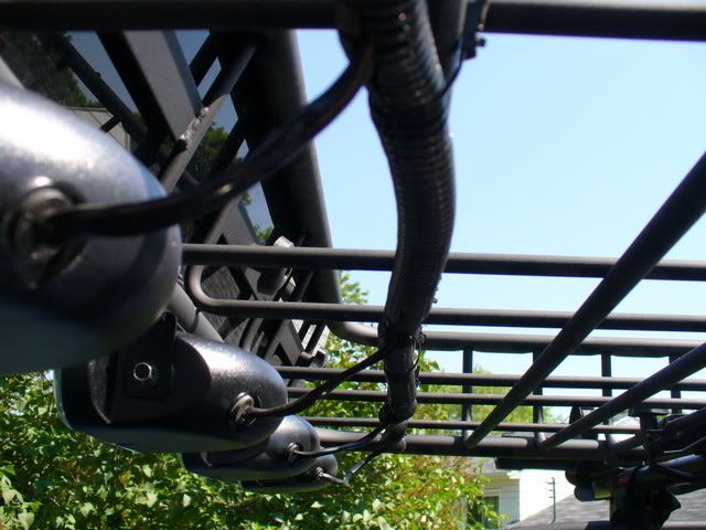

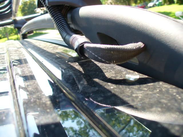

Csukoh78, I made a harness the width of the cargo rack, the pig tails coming out of the lights are in shrink wrap. Wrapped the entire thing in wire loom, drilled a hole into the Jeep's roof rack support and into the roof (used RTV to seal the hole) I then fished the wires inside the cabin and through the pillared located between the front and rear passenger doors. I got my ground from the seat belt bolt located on the bottom of the pillared. I continued to run the power wire under the door sill to the front. A few years ago I ran a large 10 gauge wire from my battery to the inside of my firewall and put a fuse block underneath the dash, I always use this for my power connections it eliminates the need to run a wire through the fire wall every time I add a powered accessory. I will post some pics later. Make sure to post pics when you’re done. Good luck!

Pics of the wiring into the roof support
Blurry pic but this is the inside of the support
