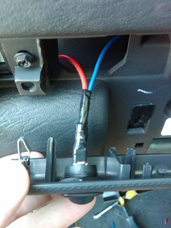

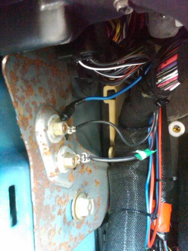

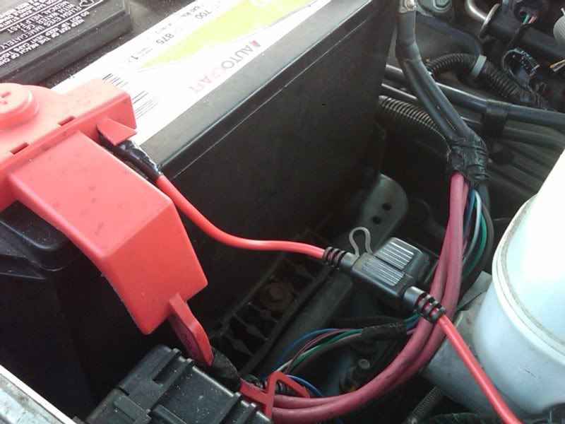

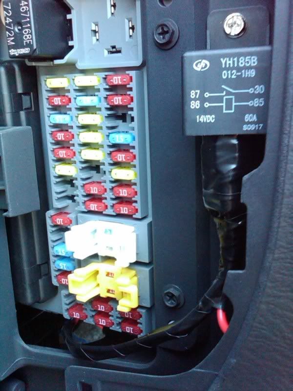

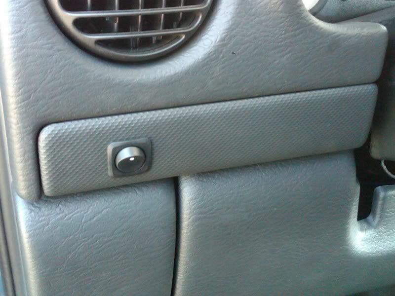

ok, so here is what I did....(dont know how to resize pictures, hope they aren't too big).
from the battery I installed an inline fuse (10a).
then through the firewall
grounded inside the kick pannel and routed gorund wire, fog light wire, and power wire into the fuse box
relay is mounted into the fuse box
from the relay to the switch, from the switch to the ACC wire in the radio harness
