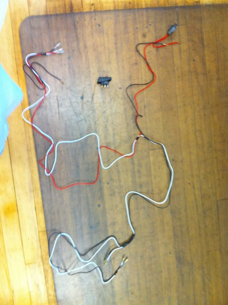

So i bought some 4x4 lights sticking them up by the mirrors by the windshield arm. How exactly do i hook this harness up?
I got the bottom set of wired hooked to the lights, just dont know what to do with the rest

The best I can see is the left part of the harness with the white/red/black hooks into the switch. White to the lights, Red to the power source, and black grounds the switch out to allow the light to light up.
Top part of the harness looks like it goes to the power source. Again black to ground red to power. I personally would use a relay system but thats just me, helps reduce the risk of your jeep being burned up
Bottom part of the harness looks like it plugs into the lights
not 100% since I can hardly see the pic but thats my guess

Zach is Correct.
Wiring is correct, Relay is a good idea.

x2 on the relay
can get a aux lighting setup from auto zone for about 7 bucks that includes a relay and wiring and a switch and just use the best of both sets of wires
