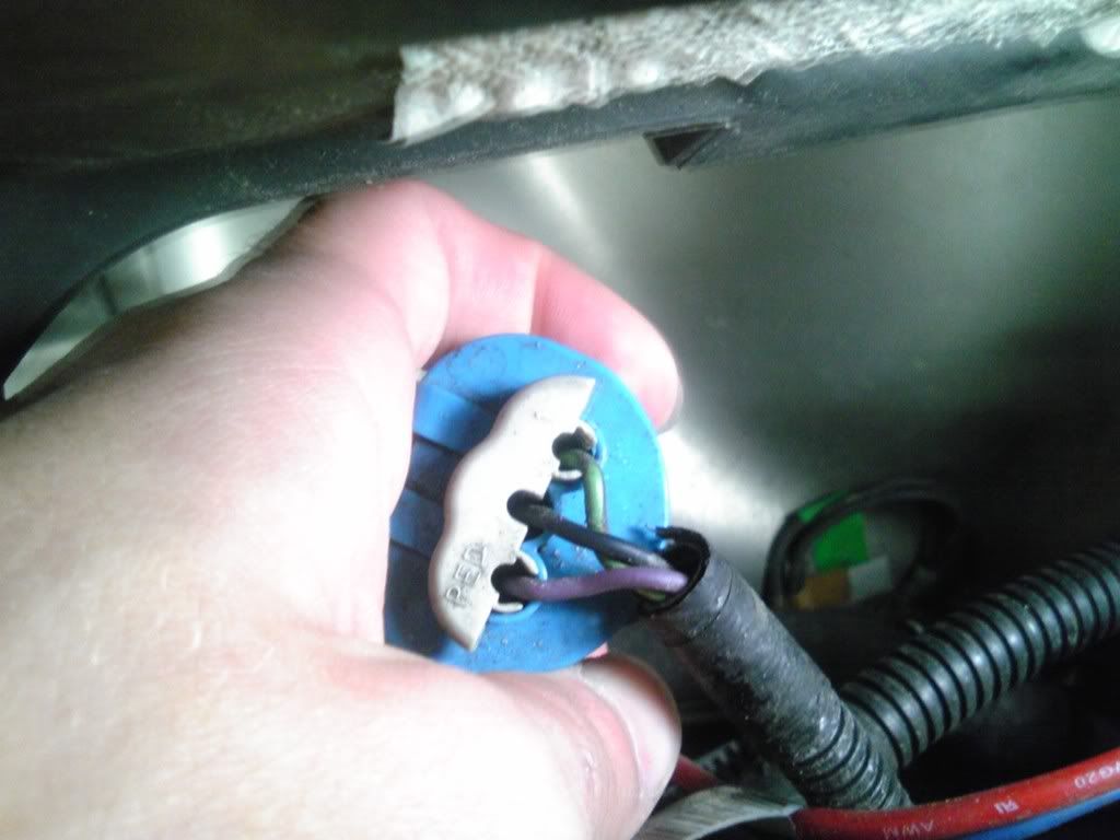

I have an '07 as well, i have enough wire to look at it, it is definitely the green wire on driver side, and orange on passenger, here is a picture of the driver side.
-dbk

exactly like mine!
