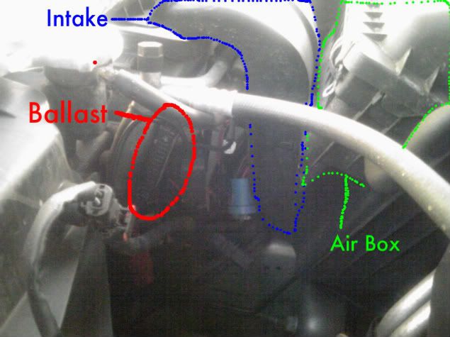

Here are a couple of crappy photos I snapped with my camera phone to show you where I mounted them.
Hopefully you can make them out.
Looking at the photos again, even I can barely see where I mounted the ballasts, lol.
I put them on the two vertical metal supports for the radiator, when you get under the hood hopefully, you'll see what I am talking about.
In the second picture you can see the airbox in the top right corner and intake in the top of the image.
in the image below, it is mounted inside the engine compartment between the headlight and the two silver pipes on the left side.
Good luck.
-dbk
