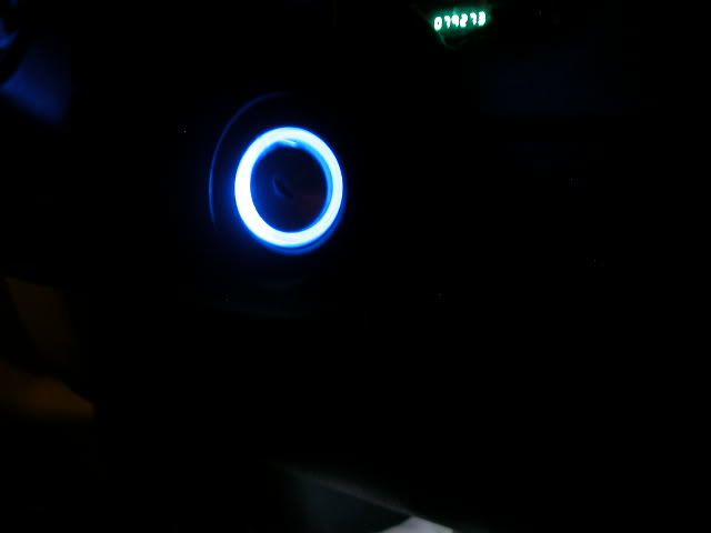

Here's the pics you were asking for,,,,,We did this to my 2005 CRD Liberty.................HJ

Thanks HJ for the pic's of the job....been a world of fun working on the KJ. Lets do the chrome door handles soon....Install time 30 mins on the Halo Light..Remember the blub from the factory is green. This is a Blue LED in the picture.......Chris
