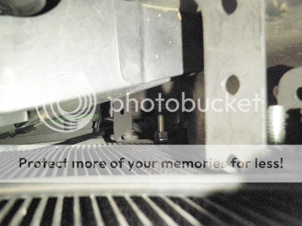

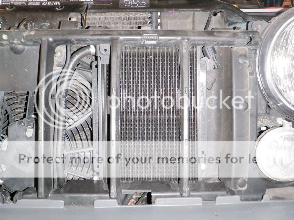

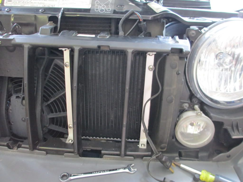

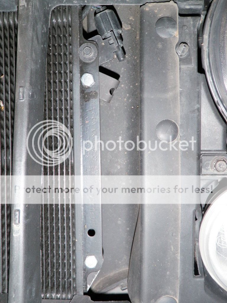

Here is how I mounted mine. It's a B&M 70268 in series after the stock cooler.
It slid right in from above without the need to notch or cut anything in the grille. I bent and used the metal mounting straps that came with the cooler into brackets that mounted in the locations which hold the condensor. The outside temp sensor was relocated a little to get into a stream of fresh air. I used 3/4" conduit to cover the hoses as they went up and prevent chafing. The fluid fills it from the bottom so air is always pushed out. There are only the two brackets that hold it. Otherwise it wedges in tight and is rock solid.
New location of ambient temp sensor:
Looking down at top bracket:
Looking way down at bottom bracket:
Looking up at the two new hoses:

I saw two posts about the "outside air temperature sensor". Is this what the ECM uses? Or is it for models with the overhead display of temp? OR both?

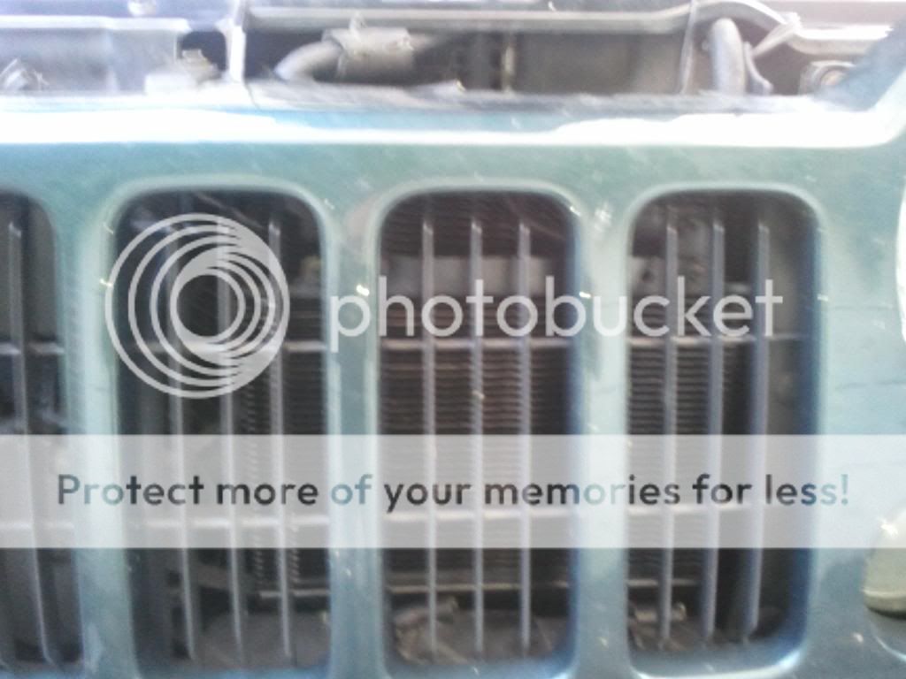

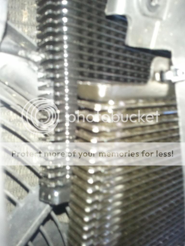

Top Fuel cooler bottom Aux Trans Cooler.
Even in the 100F heat we are having, my trans temp stays below 160F with my Aux cooler
and extra deep PMP pan. To make the Aux cooler work best, you need the air flow. When you can't drive fast enough, the Hayden Severe duty viscus fan clutch along with the 11 blade Mopar fan makes every thing cooler in high heat, The fuel cooler is on the return line side and by keeping the fuel cooler eliminates the hot weather power down the ECM does to protect the CP3.
It is used for the overhead display, I'm not sure about other uses.

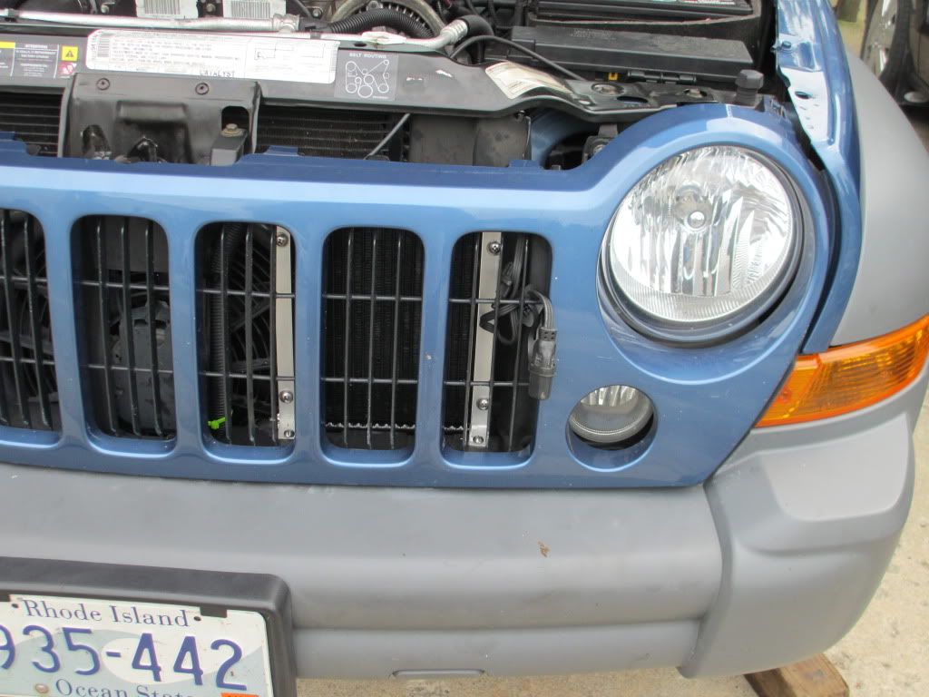

Installed my cooler today. I found out quickly that unplugging the temperature sensor would trigger a CEL.
I used aluminum angle to make my custom brackets. I also used wire loom to help protect the hoses from possible rubbing damage.
