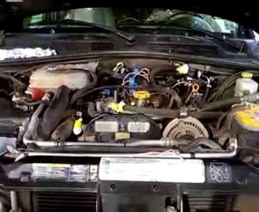

Can you make video of the engine cranking without the injectors?

Posts: 1776
Sure can.I'll try to do it tomorrow after wifey gets off of work and can set up her phone for me.

Here is the latest video:Turning over without injectors.
You don't see it but at first there was a light misty spray coming from the pistons I guess.

Are you able to hear any ticking when cranking it over...there does not seem to be any abnormal sounds like in the first video when the engine showed a loud knocking. A small borescope would be ideal, these are hard to find unless you know someone local. We can ship the injector, but it does not have a pressure gauge on it yet. Let me know if you want it and I will get it set-up properly. The compression test will only tell part of the story. It would be nice to record the pressure trace of each cylinder for 720 degrees rotation to understand if all the valves are opening properly.
