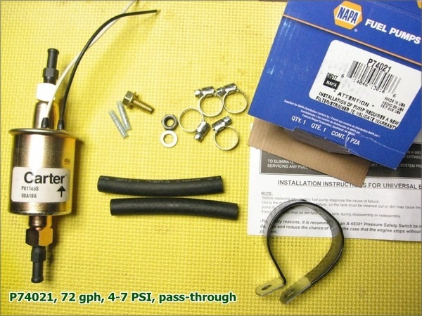

Why not go with a simple, cheap little Carter like this one:
Carter P74021, $70 for the kit, mounts inline, flow through, diesel compatible (folks have been using these on Jetta TDI's for years).
Just can't seem to locate the Carter pump in the good old Republic of SA otherwise i would.

mackruss wrote:
The Huco pump i looked at recently is a diaphragm pump so should i give it a miss although decently priced.
My Carter is a diaphragm too.
Same body and size as the GMC with barbed hose fittings instead of threaded fittings.
The complete GMC package has better vibration isolation than my bolt on the frame with rubber washers set up, but I can only hear it at idle in park or neutral in a quiet area, traffic noise at stop lights is enough to mask it.
