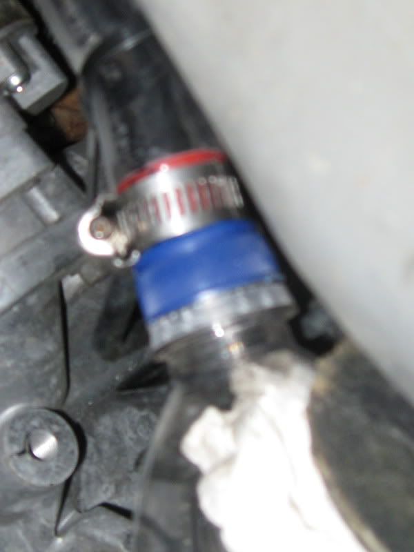

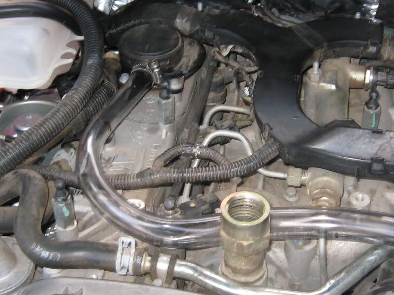

I bought 4' of clear vinyl 3/4" ID hose at Ace with two clamps for less then a few dollars and rigged it as per Old Navy's original instructions:
I inserted a water bottle sports top and clamped it on in the open position (sorry for the blur):
Punched three holes in the base of bottle and stuffed it with a couple of 2X2 gauze pads followed by a dozen or so paper towels (I call the EHM snot rags):
I figure I can change out the bottle as needed.

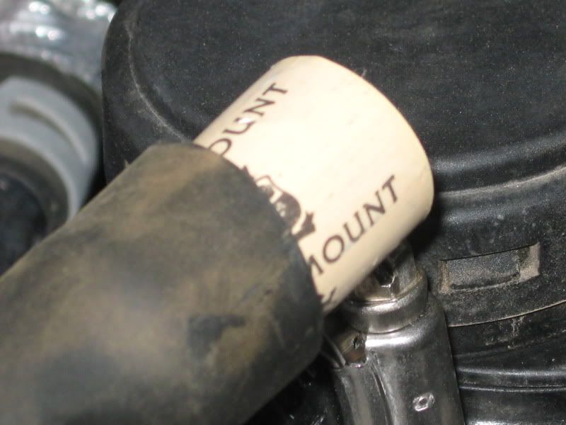

Oh, and I chose a Rosemount Estates Cab-Shiraz synthetic cork. The wine paired quite well with elk loin steaks.

BE careful here! I used that clear hose and when it gets hot from the heat of the engine, it collapses. When that happens it forces oil out of the engine in places you don't want.
You could get an old screen door spring and stretch it out and stuff inside the hose.
I went to a hydraulic hose shop and got 3/4 inch suction hose that is heat proof and already has the spring molded inside the hose. You can tie it in a knot and it will not collapse. It was only about $10 for 8 feet of the stuff.
