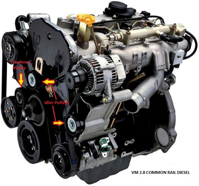

There are two idler pulleys along with the tensioner pulley! Any of them along with pulleys on all the driven items like the alternator, fan hub, AC, PS pump, and Viscous Heater can go bad and cause belt wear issues. Simple way to test is to remove the serpentine belt and spin each pulley by hand one at a time and feel & listen for any roughness, wobble, or hard to spin...they should all spin freely and make no noticeable noise, wobble, or have any looseness to them! :wink:

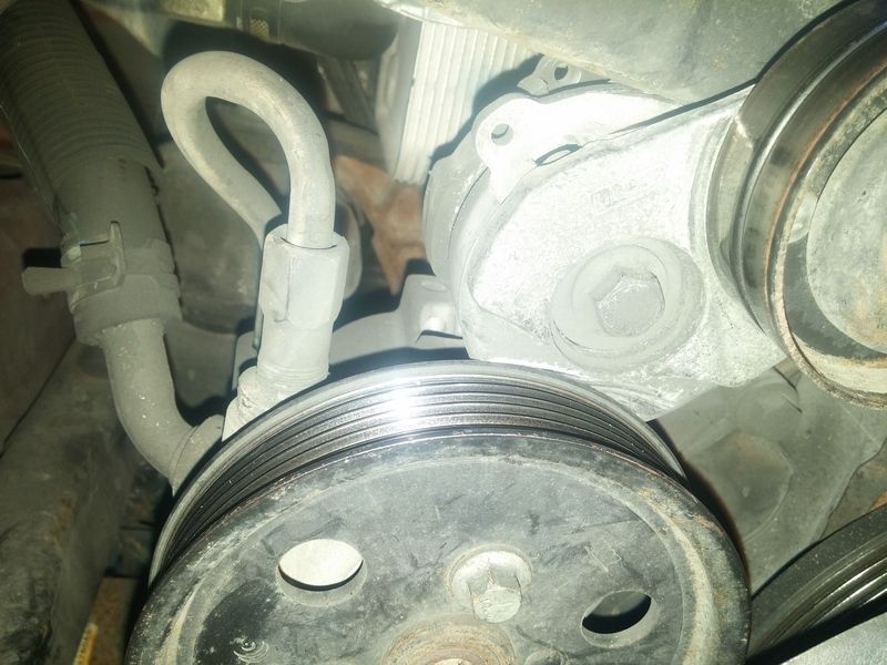

Got the belt off with no issues, then I found this,
Is it normal for the tensioner to be in contact with the pully below it when the belt is not on? If I flex the tensioner I can spin the pully below it, but when I dont have a wrench on it then it is in contact with it and I can barely move it. Not a great picture, not much room in there.
So what do you think?
That tensioner needs replaced.

When I flex the tensioner it is not in contact with the other pully. As I have been driving the jeep it is a logical conclusion that it has not always been in contact and may have just done it when I removed the belt, It also stands to reason that the tight belt would pull the tensioner enough to clear the pully so it does not rub. I took the belt off and now it is in contact. When I put torque on the tensioner it spins freely.
I just find it odd that the bottom pully managed to grind into the tensioner bracket. Wouldn't that indicate a issue with the bottom pully or is it maybe that the tensioner bracket has come loose over the years.

The power steering pulley should not be touching the tensioner.
Remove the PS pulley and then remove and inspect the tensioner.

One of the classic signs of a failed serp belt tensioner is leaning into the power steering pulley when tension is released. Combining that with the squeak I strongly suspect that your alternator decoupler pulley has failed which causes the serp belt tensioner to bounce somewhat violently which causes the tensioner and belt to fail. That said I'd check the "feel" of all the spinning things as noted by WWdiesel. Replace any that feel bad (NOTE it's easy to pop both idler pullers off and check for weeping grease in back but remember their bolts are reverse thread - clockwise to loosen). If I am right you will need a new serp belt tensioner AND alternator decoupler pulley (Litens 920834 is slightly but insignificantly smaller than stock and recommended by Litens) although some find it easier to just replace alternator especially if it has a lot of miles on it.

Thank you so much for the advice. I plan on ordering the tensioner that was listed in an earlier post on amazon, I do have a lot of miles so as a precaution I will take your advice and put a new alternator on as well, may as well do it now.
