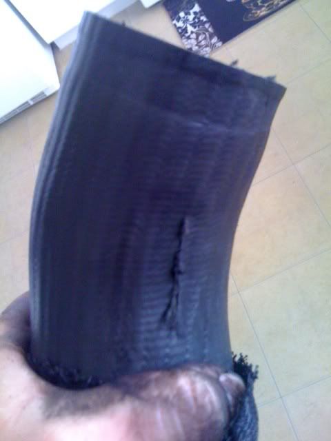

Alright.......after further review......SPLIT HOSE baby! Sure enough....the driver's side hose going from the intercooler to the intake had a 1.5" split in it. I could stick my thumb through it and see my thumb inside the hose. It was on the under side near the intake. You would have never have known if you didn't take the hose off and pull back the mesh. I have already called the dealership I just came from to let them know (I'm not done with them yet!) and I'm off to my local dealership who has the hoses in stock. The turbo side hose actually didn't look as bad as I thought it would. Guys.....thanks a million for your help. I'm not celebrating until the new hose is on and she is right but I think it is safe to say that was the issue. I'll post again when I get it on.

Not bring an old post back but I did hear back from the dealership shortly after the first of the year and after speaking with the service manager.....I did get a check in the amount of $85 back in the mail to refund my diagnostic charge. Also.....I am attaching 2 photos of the split hose.
This is a pic of the split itself on the underside of the CAC-intake hose:
This is a pic of my thumb in the split to illustrate how big the split really got:
Thanks again guys....
