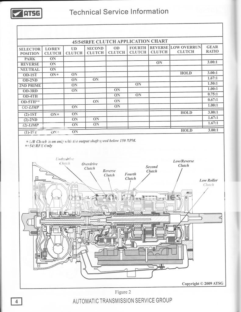

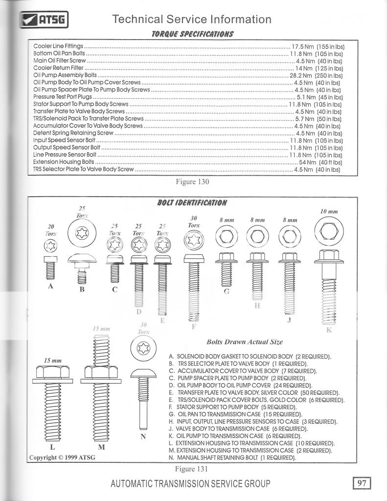

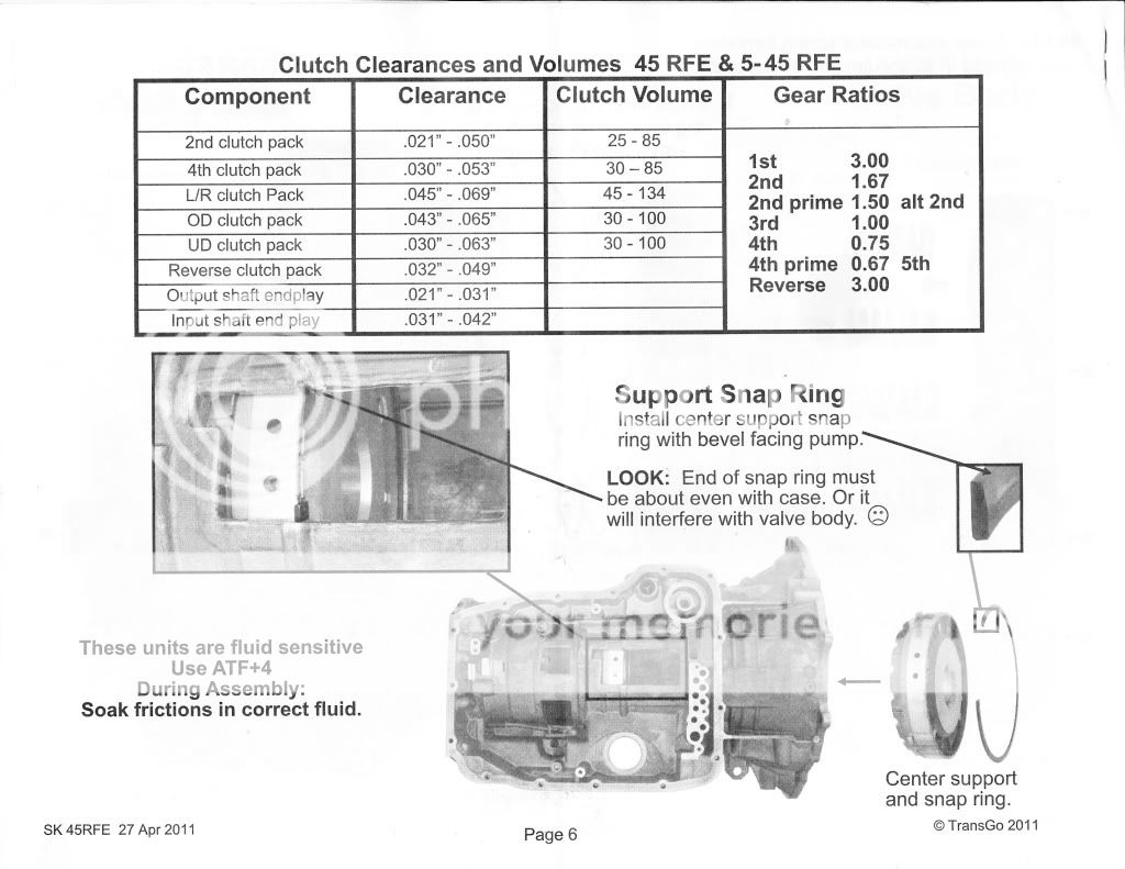

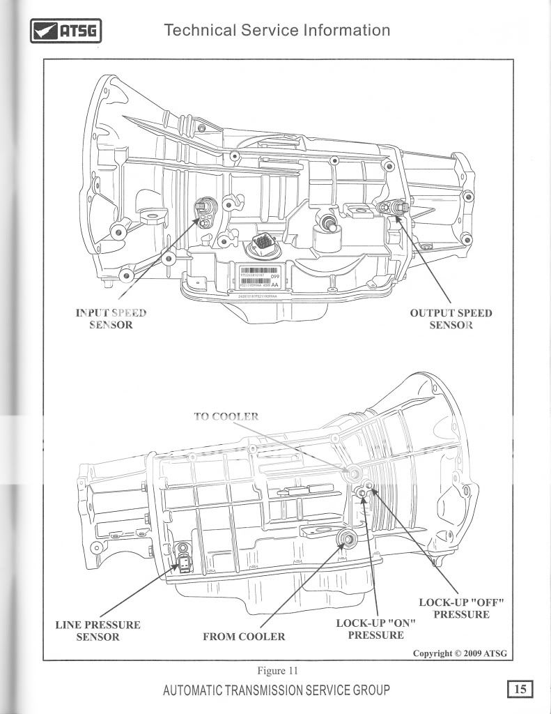

Sorry for the delay gentlemen, been crazy busy at the shop...
Speed Sensor locations
CVI index, gear ratios, and one of the problem snap ring locations (the real problem ring is in the underdrive input clutch)
Torque specs for the entire trans and fastener identification
Electrical apply chart...
There are some more useful images, but they're mostly for those looking to rebuild the transmission.
Stan

I really loathe letting other people who may or may not be competent work on my vehicles. The problem is that I just don't have enough hours in the day. Option b) is what I was leaning towards, as it saves a lot of time for me and maybe some bucks, while at the same time allowing me to keep an eye on things and avoid wiring chafing, etc.
Stan, how likely is it based on what I described that what I was told is correct? If so, then in order to get at the worn clutches I would have to disassemble the transmission anyhow, right?
Also, would a Transgo kit add any value to such a rebuild?

Haha, I completely understand your feelings on allowing others to work on your vehicle... Yes you will need to tear the transmission down to replace the OD clutches. He probably looked at the CVIs and saw something on the high side either in the OD input clutch, or brake clutch values to conclude that they are worn. Depending on which set of OD clutches is worn would decide whether special tools are needed to replace the worn clutches. The inputs are just under the front pump, in the input clutch hub and requires few tools. The brake clutches are under the center support and require a special press arbor to remove and install the snap ring that retains it (the same one that is visible under the VB).
The Trans-Go kit isn't terribly expensive, and it includes a few parts that can help your trans live as long as your engine.
