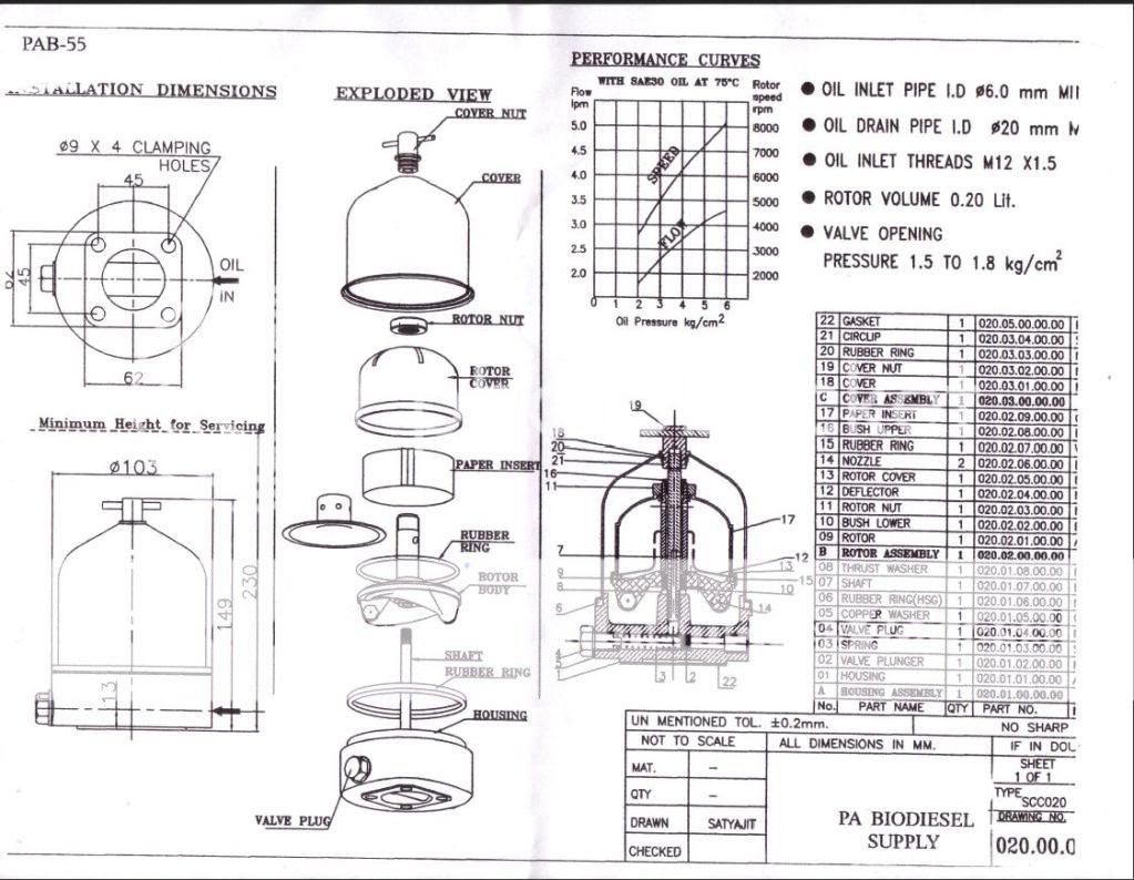

The centrifuge does not come on until the oil pressure reaches 30-35PSI, to prevent engine damage. Also the jets that cause the spinning action are only 0.045 inch in diameter using up to 55 GPH or 0.91GPM. Ratings for the centrifuge are at the max pressure, mine is 85PSI. As you can see in the chart, the flow of 0.66GPM at a normal down the road at highway speed of 40PSI to 50PSI, is not a lot.

warp2diesel, Thanks for the info.
I have heard about them, but never looked into it much. This is another mod I will do.
These are the sort mods that i am into more these days, building in more reliability. In some ways fixing it before it's broke. Whereas before, why fix it, if it aint broke. Comes with age i suppose, 50 this year.
Looks like a fresh install by the photo, very nice.
I'll have to check in the morning, if i have the same space to fit it. Are you using the drain as the mounting bracket.
Has it extended your oil changes.
Is it a messy job to clean out, ie, dripping oil from the cover, or do you lift out the whole unit.
Did you use the same port, that the oil pressure sensor came out of, as your feed line.
Sorry for all the questions, but i am now very interested.
One last one for now, Can't see the part number clearly in the scan.
