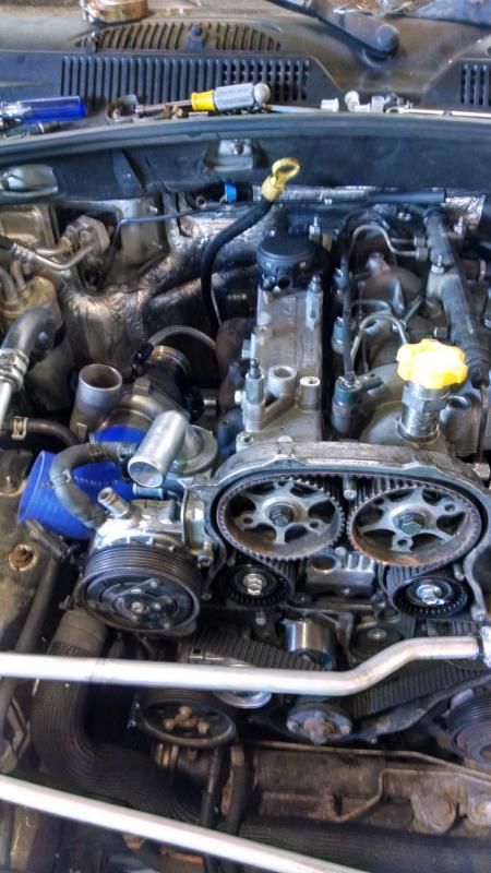

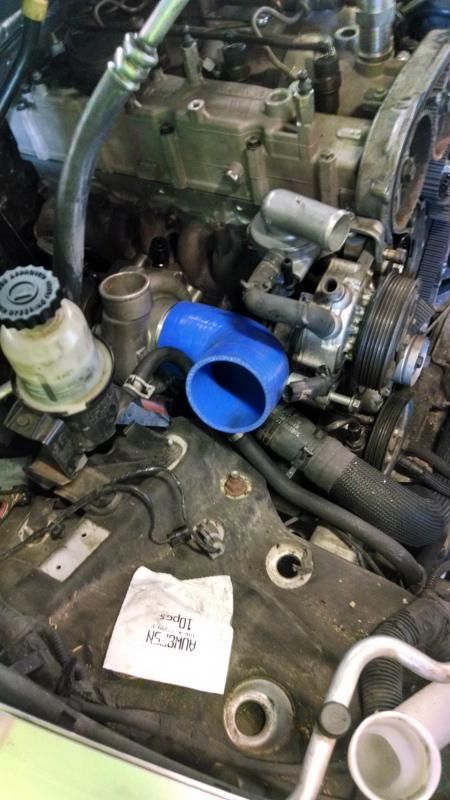

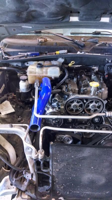

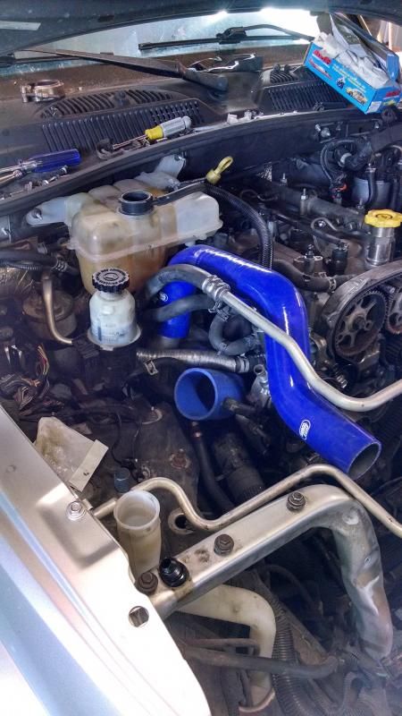

The heavens finally opened up and the stars aligned to finally give me a day and a half off this weekend. Going together awesome. Still have to modify the water pump elbow, and change the coolant plumbing to feed the turbo housing. Should hopefully have it together and running tomorrow.

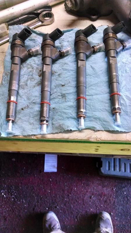

Had the injectors inspected, honed out 25% (50hp), cleaned and reassembled for $275 a piece.
It fits!
Everything else clears perfect. Even the samcos fit/look right.
Not sure what I'm going to do with all the room on the passenger side now.
Jeep goes in to the exhaust shop to get a full 3" made for it. While it in there I'm going to have them bend me some metal intercooler tubes. The list of jobs is still lengthy. Finish assembling engine, install rad/ intercooler/ grill etc. Install fuel tank, hook up wiring harness for in tank lift pump, hook up/ install a pillar gauges. Then its change engine/ trans fluid, top off coolant system, and give her a whirl.
