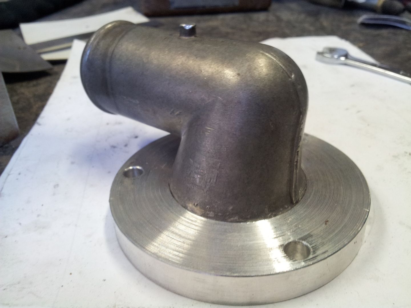

whiteninja1 wrote:
I was attempting this way building a thermostat housing.
viewtopic.php?f=169&t=50940
I am all for experimentation; hey, it is your vehicle to play with (things like brakes may be the exception).
That said. Maybe you could try a Kap/Sarge hybrid if the Sephia cap can't be found.
Use Sarge top:
Do the lower as Kap.
No welding that way. Change the plastic fittings to brass.

If you can use a lathe, the only tricky part is figuring out the distance that the lower insert sits below the seat of the thermostat (note: thermostat from 95-99 Hyundai Accent 1.5L).
If you use the dimensions of Kap's lower insert, you will need to machine the stat base to give a distance of 1.525 inch minus the thickness of your crushed gasket. Shown in the diagram is not correct.
Curtain area of bypass valve
Should be equal to the area of the bypass port (lower hose fitting).
-bypass port diameter (hose fitting) = .479 inch
-pi x (.479/2)^2 = .18 inch^2
-bypass insert inside diameter = .87 inch
-curtain area is = pi x diam x lift
-curtain area should be = pi x .87 x lift = .18
-thus lift (bypass valve gap) should be = .066 inch when the top valve is just cracked (190°F)
So
The gap at the bottom bypass valve is .07 inch just cracked past the end of the sleeve (the point where coolant really starts to flow to the radiator). Perfect height! But the thermostat sits on a gasket.
Again: machine the stat base to give a distance of 1.525 inch minus the thickness of your crushed gasket.

TURBO-DIESEL-FREAK wrote:
.. there is less welding that what Sarge is doing).
From the pictures that I posted, it looks like the top is just machined. I may be wrong though. Maybe Sarge can weigh-in.
That would make the hybrid design weld free.

SargeIndustries wrote:
It is welded from the bottom, if I understand your question correctly.
Is part 2 welded to part 4?
edit- closer look says welded. It originally looked to me like you just turned the elbow into the new top.
I can't comment on the weld-ability of the original part; just throwing out ideas.
