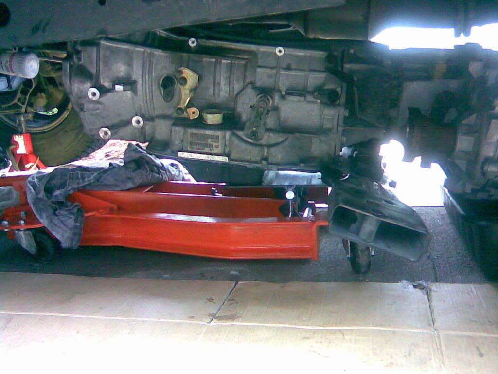

Well, the goodies are in - I dropped the trans\xfer case assembly complete with cross-member attached - easier to do, easier to balance on the trans-jack, and the attached x-member allowed positioning with the knees while the hands were otherwise occupied
The Suncoast torque convertor is much tighter than the DCX version -
DCX impeller\turbine vanes are just a RCH off exactly vertical to the axis of the t\c - no cupping, loose
Suncoast version is way more aggressive, with a pronounced cupping arc from center to circumference - it got hookup, folks.
The Transgo shift kit went smoothly - left out the pressure-boost resistor for later switchable installation, when time permits observance with scantool
(Thanks for the DRB reference pressure, DZL_LOU)
Check the pics for reference -
Note the radial dimples in the t\c cover, which locate the turbine and impeller vanes - any curvature from the center outward depicts vane angles, or cupping - the cover is the impeller - inside, turbine vane angles match impeller vane angles
- reverse curvature = little hookup, hi stall, for small displacement engines
- straight, little curvature, as shown = better hookup, lower stall, but slips badly as power increases
- deeply arced curvature = very aggressive, lo stall, very efficient hydraulic hookup
http://www.lostjeeps.com/forum/phpBB3/vie ... 007#255007
- the rusty bit is the DCX oem F37 'upgrade' with stamped steel TCC clutch housing , straight impeller vanes, and plastic stator - there are two large chunks of steel counter-weight spot-welded onto the housing circumference for balance - Jeep passes this off as a torque convertor.
- the painted version is the Suncoast 2.8L CRD offering, with cnc-machined billet steel clutch housing for positive TCC apply, aggressive impeller vane angles for excellent low-rpm hydraulic hookup, and cnc-machined aluminum stator for reliable off-the-line 2.4:1 torque multiplication - oven-brazed fins for increased rigidity - a manly-man's Diesel torque convertor.
Also shown is the oem Torque Convertor Clutch - the last pic is the clutch plate area of the drive cover, showing the burned areas where the disk was not applied full circle - this was likely caused by warpage of the stamped steel cover - the disk has been applied with only partial contact - this would cause slippage and shudder, eventually burning the friction material and depositing it in the fluid, with eventual transmission loss
That pic alone speaks volumes for a replacement billet torque convertor like the Sun Coast version
The next-to-last pic is of an aluminum stator - but you got a plastic version of that in your oem DCX convertor, similar to the custom-finished version in the last pic - Sun Coast cnc-machined a new aluminum stator for the CRD 545RFE trans.
Note also the oven-brazed turbine-fins in the next-to-last pic - no girly-man convertor, there, folks.
Also shown is the redesigned pump cover plate with relocated front seal for the F37 pump upgrade.

I have the HEMI TC on order and should arrive in the next week or so, part number PN04736587AC from the 5.7l hemi 07 (revised and upgraded). Several Dealership service department guys have suggested that after the install that a "Quick Learn" be performed on your Liberty/Cherokee, and will also need to ask to have a (Torque Convertor Break-in).
I wonder if some of the Suncoast and other TC installs are missing out on this and perhaps this might be a reason some are not enjoying the benefits as quickly as they otherwise might be.
I had not heard of the Converter break in procedure before?
UPDATE: HEMI TC done. Tis Better.....
