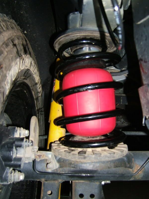

Well, I just linked to a picture that Jeepjeepster posted that shows his new airbag in his rear spring for load leveling, but the part I'm wondering about is the pad that the bottom of that spring is sitting on. It is called an isolator pad and sits between the steel support plate for the spring on the axel, and the spring itself:
Is that black pad still there with the Daystar puck just placed on top of it?

I think that orange "bumper" is what I hear "hitting bottom" on the RR tracks.

onthehunt wrote:
Those air bags are a good idea. I hauled a trailer full of oak the other day and the axle was sitting on the stops. Sure rode nice though! Where did the air bags come from? I'm thinking of using some semi cab air bags I have here at work. They look like they would fit just right. The price is real good too!!(free)
You'll have to send a private message to a user named Jeepjeepster about the airbags because that's the user I borrowed the picture from in my previous post. If you do a search for air bags I'm pretty sure I remember a topic on them with a link to click that sends you to a supplier with a price.
I can't speak for CRuD Bucket, but my lift and tire upgrades ride better than stock. My front end is not lifted as high as CRuD Bucket's, but our back spacers are the same. The only thing I'm missing from his set-up is the metal spacer that goes between the top of the strut assembly and the mounting point on the Jeep (in essence, pushing the entire strut assembly down). We both have the front spring spacer though.
With just my front spring spacers, my CV angles are nearly level so there is more room to lift if I decide to go higher later on.
