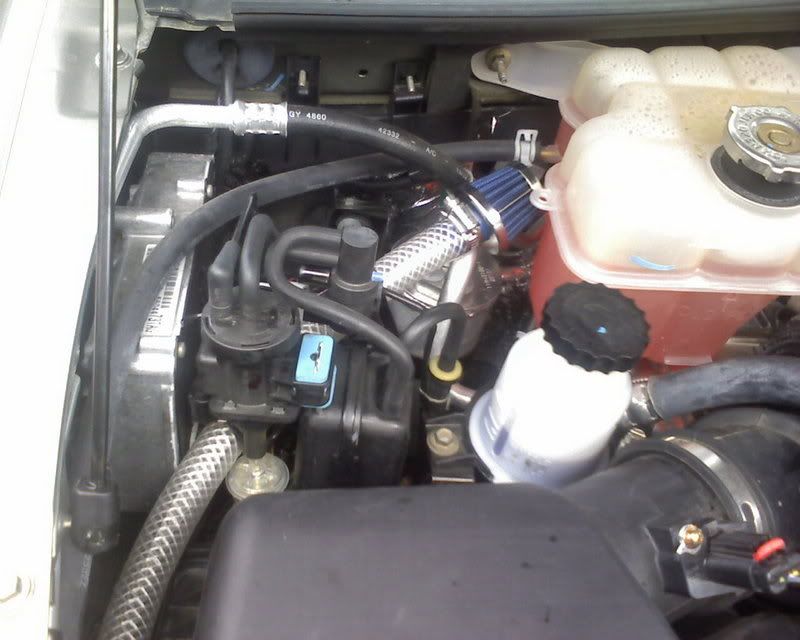

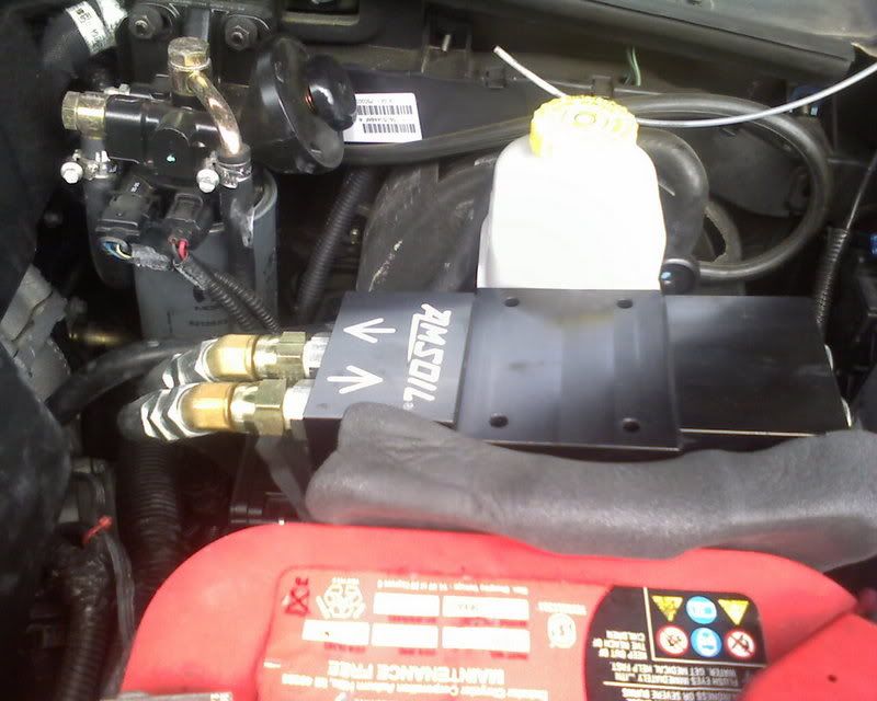

Installed elephant hose mod today
2nd attempt to share pics to see what i did...
Bypass kit pics:
http://i203.photobucket.com/albums/aa19 ... ss-crd.jpg
http://i203.photobucket.com/albums/aa19 ... 07_064.jpg
Elephant Mod pics:
http://i203.photobucket.com/albums/aa19 ... 06_063.jpg
http://i203.photobucket.com/albums/aa19 ... 06_062.jpg
http://i203.photobucket.com/albums/aa19 ... 06_061.jpg
http://i203.photobucket.com/albums/aa19 ... 52_055.jpg
The vent steams a bit but doesnt get out of control er nothing.....
Interesting enough my VW TDI looks like it has a heater b4 the oil gets to the intake to the turbo, the Jeep CRD does not appear to have this. I capped off the old hose w/ a wine cork worked great!

What does the bypass kit do?
Chad Hargis
Nashville, TN
2008 Grand Cherokee CRD
2005 Liberty CRD *SOLD*
PostPosted: Sun May 06, 2007 6:26 pm
Joined: Mon Apr 23, 2007 5:31 pm
Posts: 163
Location: buckeye AZ
Its a dual oil filter system, Main filter does the usual thing, then theres a bypass filter that filters to 2microns virualy eliminating the diesel soot in the oil system.
One cannot just simply run the 2micron on its own as the flow rate would be too low for the heads to lube, and the oil pressure would be too high and break somthing. So the majority of the oil flows through the main filter and about 10% circulates through the bypass. All oil cycles through main filter about ever other minute er so, all the oil cycles through the bypass every 10min er so. Supposed to be really good for a diesel motor to have....
Oil "can" last very much longer than normal up to 60K miles. Im about to hit 1K on the oil and the bypass and will be doing an analysis on the oil this next week just to make sure everything is running ok. Oil pressure has stayed normal so far too.
though i was hoping the kit would get the "black" out of the oil,, it doesnt =( tho i can only assume its doing something, will quantify that at the end of the week when the analysis comes back.
Bump!
I'm very curious about the Amsoil bypass filter. Which kit? Any oil analysis results?
--- SEGR Builder ---
PostPosted: Tue Sep 11, 2007 10:09 pm
Joined: Sun Jul 15, 2007 12:17 pm
Posts: 100
Location: Richfield WI
I'm curious about the Amsoil Bypass Kit as well.
Which one did you install and how did you shoehorn it into that location?

I'm also curious about the Amsoil Bypass Kit.
can you show more photos :?:
