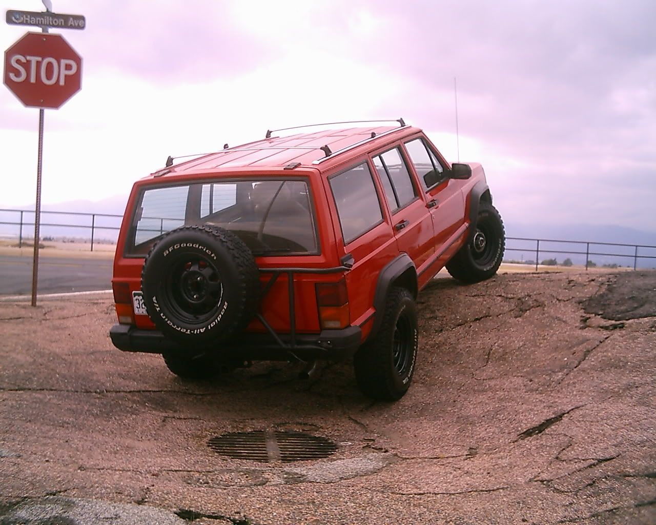

Seconely, my factory fan clutch on my 86 jeep Cherokee snapped, and put my factory jeep fan through the radiator spilling coolant EVERYWHERE on HWY 94 and left me stranded...this is more likely due to the factory fan blades being angled next to the radiator, where as the flex fan is relatively flat at the front and the blades curve away from the radiator (unless of course if it was put on backwards!?!). The blades will flex in water very easily as well unlike the factory fan that does not. Also my adapter is STEEL not aluminum so it should hold up better/as well as the aluminum fan clutch. I'll take my chances...though I don't PLAN on fording any streams nearly 2 feet deep. (I just measured 23" from the bottom of my fan to the ground)
Here's my 86 that had over 256k miles on her little 2.5L throttle body injected 4 cylinder before trading her away.
R.I.P. Old friend:
