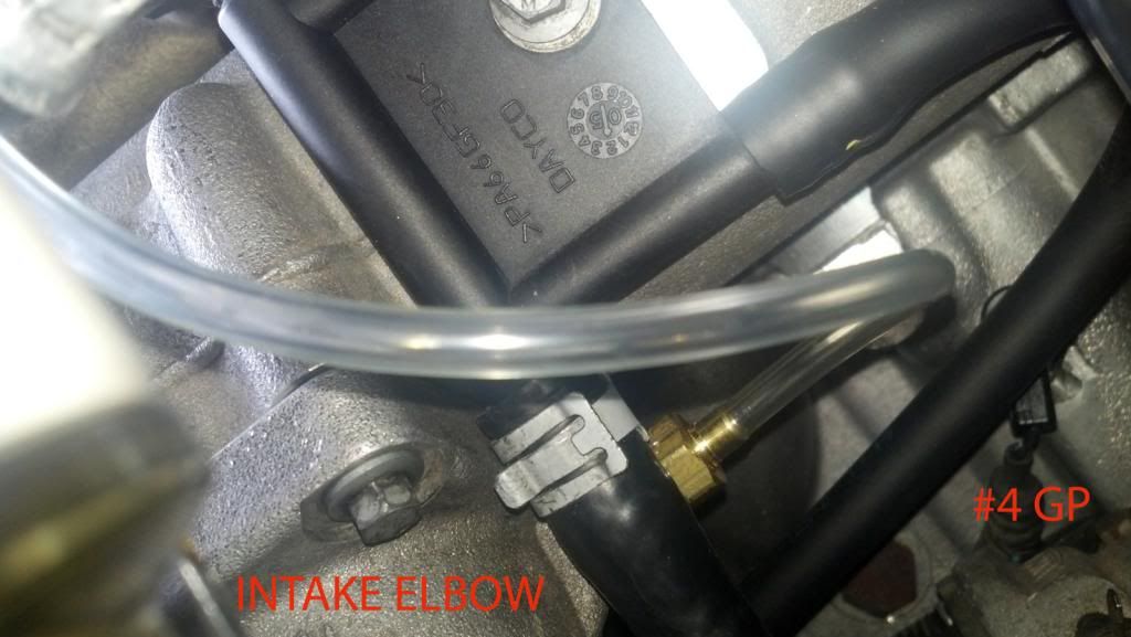

I had requests to show where my boost gauge is attached. This is the best I can do at squeezing my cell phone in to snap a picture.
I didn't drill and tap it. This may be an easier location IF you are not pulling the whole valve cover/intake off.

Posts: 5431
Works fine if you have the intake elbow off to swap glow plugs or get at EGR. An alternative is apparently on top of the engine. Remove plastic engine cover; draw an imaginary line between the oil fill tube and the oil dip stick; about 1/2 way between there is an obvious threaded hole that can have its base drilled thru into the intake and used (see viewtopic.php?f=5&t=69804).
I plan to do glow plugs so now will have to decide which place to use.

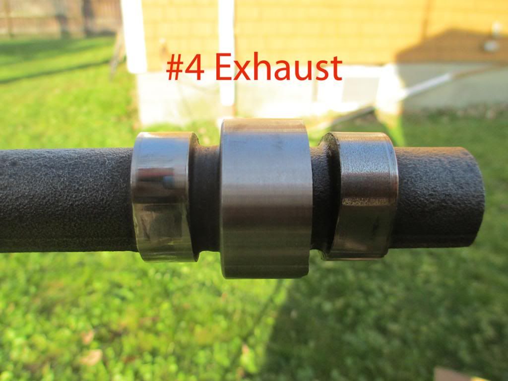

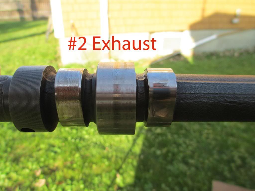

Here are a few pics of my cam.
Here is a link to a YouTube Video...
http://youtu.be/8ELktBoWozI

serious fudged up there, your'e scarin me
