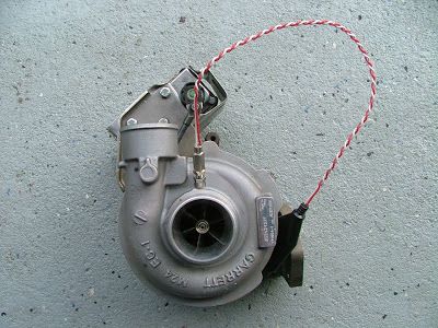

Looking at the damage to the turbine, IMHO there has been FOD and/or rubbing on the variable turbo vanes on both this and Choochooman's turbos. Not sure whether it would be bad bearings or whether there can be a failure that allows the vanes to exceed a certain angle that would cause the tips to hit the turbine. Choochooman's pictures do a good job of showing the vane damage.
Maybe metal failure on the vane tips? Once the first piece breaks it would get ugly. here's what happens when you loose a blade on big jet engine.

Definitely damage to the fins on the exhaust turbine wheel in my pics, likely due to the bearings wearing just enough for those fins to touch the housing, or major pieces of carbon coming by from the internals as I did the ITU runs. Any such carbon or FOD from the turbine would have continued on out the exhaust pipe once in perhaps bounced around a bit, possibly hitting other fins and causing further damage. The variable vanes in my turbo are fine, though they were caramelized-carbon-impeded, thus causing over-spin of the turbo, higher than normal heat, likely bearing wear, and so on. I didn't show the cleaned variable vanes themselves in my cleaned up parts pics since they were still soaking to remove the carbon... they are visible in my first pic showing the dirty internals. They were very dirty, but not damaged... their slight disarray is from being nudged while I handled the parts after diss-assembly. The light colored deposits on those variable vanes is residue from the oven cleaner I had tried before deciding to just remove the turbo from the vehicle to give it a proper cleaning.

Apologies to CGman and ChooChooman74... there actually is one damaged variable vane. If you zoom in, you can barely see the damage in my 'dirty' turbo pic, on the wheel at about 1:30 there's a fin that looks a little short... because it is. Its thin end is slightly chewed and bent. Could be where the material came from that ate the exhaust turbine... but what ate the fin? Guess I'll check those glow plugs.

That looks like pretty classic fin tip contact with the housing damage due to worn bearings not something passing thru the turbo. Have you looked at the housing for signs of contact adjacent to these fins?

After cleaning, found several other vanes damaged. No apparent housing damaging / marring from vane contact. I'll be checking the glow-plugs just in case, but the old turbo is being set aside... not worth any more investigation time.
