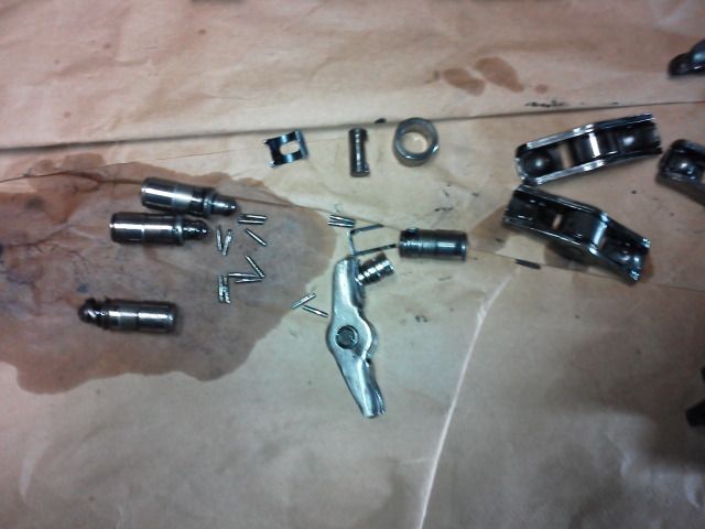

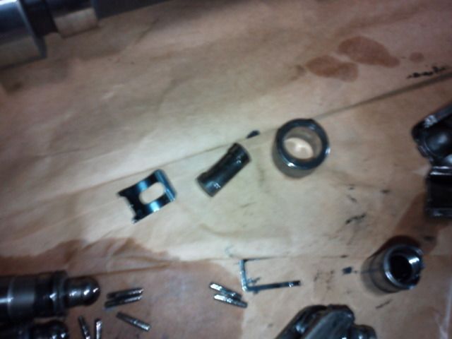

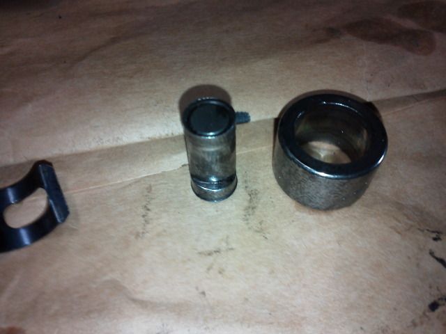

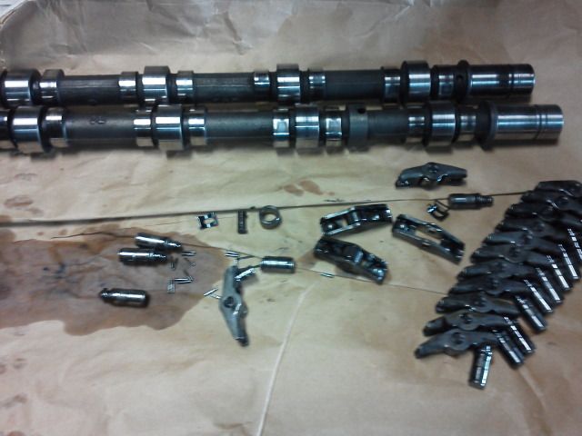

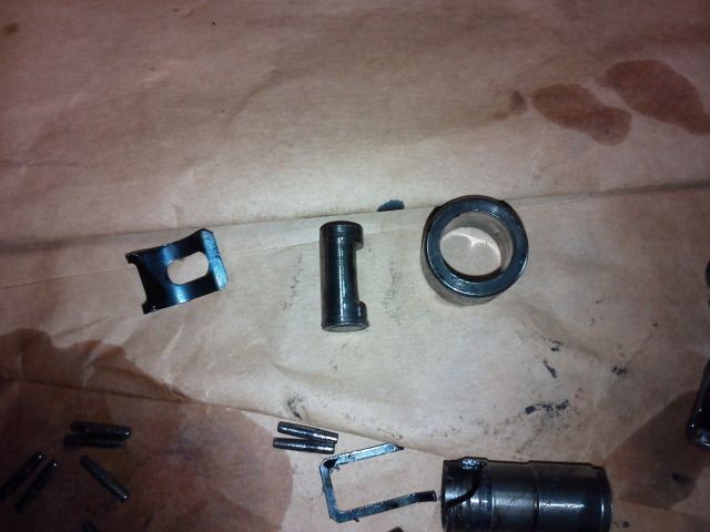

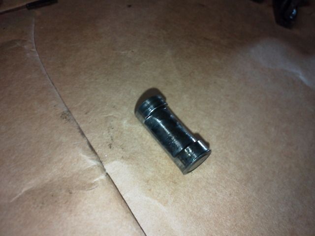

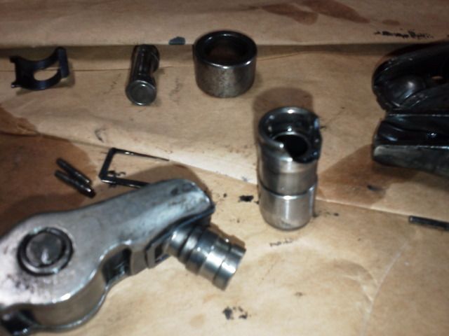

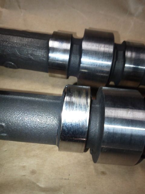

You can barely see the chatter marks on the cam lobes, but still I replaced. Also because one rocker roller wasn't rolling at all. See how bad the wear is on the roller pins??? WOW...... and at least one broken lifter and there were several laying on there sides where they had come off. JUNK.... All of it. So I replaced all the rocker/lifter assemblies, and both cams along with the complete timing kit from IDParts.com (THANK YOU).

Great Job!!!! Just think of the $$$ the dealer would have charged you? If they could have. Most have no clue. Now you can.
So glad things worked out for you!!

Once again congrats on finding the issue right away and getting it all fixed and thanks for the photo update!
Astonishing that at 92k miles things could be that worn! So what oil are you going to be running with the new valvetrain? And I think you mentioned you are getting the GDE tune? Should be good to go then! I love the tune, it fixes so much like the fuel gauge and the driveability is amazing. No more dead spot from the start till about 10mph. lol In the mean time you probably heard that you can disconnect the Mass Air Flow sensor to disable the EGR valve as that is the only function of the MAF...to control the EGR. That way you won't get any more soot in the oil while you wait for your tuner device to show up.
