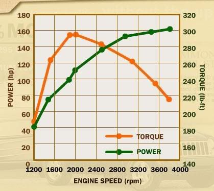

 Post subject: Here is the HP/Torque Chart we have been looking for
PostPosted: Fri Jan 19, 2007 7:47 am
Posts: 3544
http://www.jeep.com/crd/ then click on "powerful"

This torque curve chart has been available through VM Motori's website. In fact, they have just cut and paste it to the Jeep website, since it is the same color scale and size.

Now the real questions is......
Are these number pre or post F37 adjustment? We need to get a couple of CRD that have had the F37 on the dyno to get some numbers.

The importance of this graph is for the aftermarket TC builder. Gives them some info they need to figure stall speed ect.

How about this:
Image removed due to better image posted below.
This is sales material. Numbers reflect the specifications for the vehicle as sold. I.O.W. it's pre F37.

Added grid lines for easier referencing of numbers.

Hmmm, roughly 190 ft/lbs of torque at 1200 rpm. If the chart is anywhere near accurate, sounds like this beastie would handle a 1200 rpm converter just fine.
BTW, I found the original sales brochure that came out in Jan '05, for the '05 CRD's. Can't scan it, but I'll compare to the posted chart for '06 to see if there's any difference.

Compared the above graph with the one in the January '05 brochure. Same exact graph, all the data points match.
