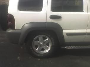

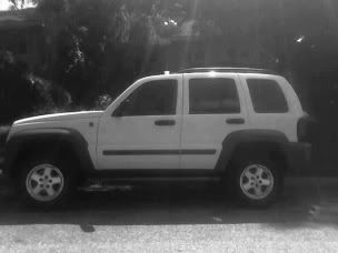

Not the best pic from a camera phone...also it is parked on an uphill...but here it is:
This is the lift parts that you can buy separate...$793.00 plus shipping. This comes unassembled and you use the stock hardware...not a problem whatsoever. You just have to buy or make a small 2" bracket to remount the rear brake line. I just wanted some of ya'll to know that you don't have to go the $1100.00 route, you don't have to ship back your cores and it works just fine. Man it drives so smooth! Without the extra spacer in the front strut you get 2" of lift and the CV Axles are LEVEL! Plenty of space for the UCA to droop...and I don't think I will need Als UCA's.
PS: I bought this one from rs4mtnitro (5 months old) since he traded his KJ in for a Chevy Truck. I paid $800.00 shipped so I figured it helped him out and I saved the shipping costs.

I have 29.84" tires on there now...235/75/16s...the front to rear wheelwell is still tight when stuffed
Hard to tell from the pic...will get better with camera later...but these actually look pretty good on there as it sits. They are only about 3# heavier per tire than stock, they fit on a stock CRD so you can get the tires "first" and then the lift, you don't need to hammer any pinch weld which you would most likely have to do with 245/75/16s, the speedo is only about 2% off with these and they are not going to cause a huge decrease in mpg. I have tried to "Build" this without adding much weight...[Aluminum Skids (engine/tranny-transfercase/fuel) ...75#]...[Step Sliders...50#]...[5 Tires...15#]...for a total of just 165# added weight. The lift parts probably didn't add much to the mix when it comes to weight. I am thinking about removing the rear seat and building a flat floor in the near future...will save a bit of weight and I never really use the rear seats anyway.

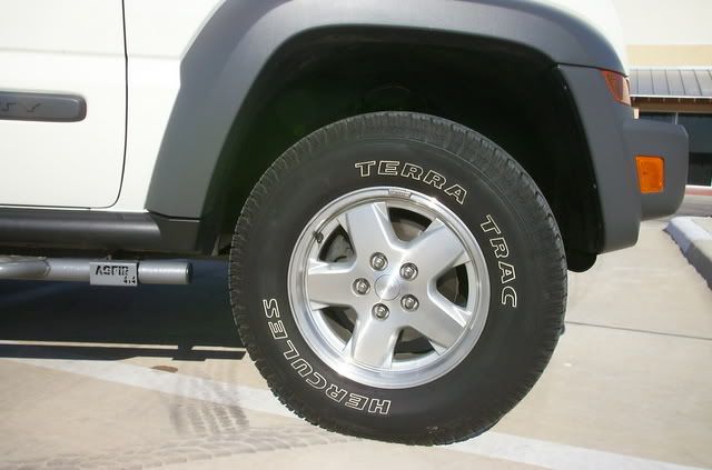

Better pics:
Front pinch weld clearance:
Overall look:
CV Axle Angle, it is a bit hard to see but it is basically level:
Can see the AT tread pattern of the Hercules and the ASFIR Engine Skid

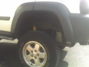

PostPosted: Sun Sep 30, 2007 12:01 pm
Posts: 3544
A little OME Rear Droop:
You can spot the ASFIR Aluminum Gas Tank Skid
A little OME Rear Stuff:
You can see the ASFIR Step Sliders
