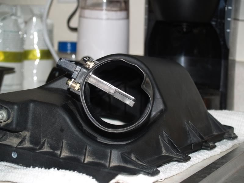

went to clean my airbox and noticed a divit in the rubber hose going from the turbo to the airbox, right over the O-clamp where it connects to the air box. Needless to say my engine's been suckin good ole Dusty air for who knows how long....
under further inspection it seems that some cobination of events has taken place
1) clamp was clamped too tight by the last knuckle head who took it apart and caused the airbox tube to collapse
2) arizona heat warped this thin piece of plastic.
3) some combination of 1 and 2
place of collapse

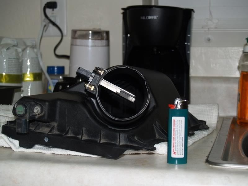

my quick fix :D

You could measure the inside diameter and try to find a piece of pvc that has that has an outside diameter to reshape or reenforced the damaged area. :evil:

Agreed, you could try some thin wall PVC or copper pipe to reinforce the plastic tube. The Behr radiators at work have sections of copper tube glued inside the hose connections to reinforce them - we're talking 18 wheeler radiators.

from the look of the agressive crease there, I'd say that someone's screwdriver slipped past the clamp and entered the gap where they connect, creating that divit....its not a soft bend inward like would be casued by overtightening...looks like an impact on that metal with a flathead screwdriver. i am with you...the "knucklehead" who did some work last time.

well I was doing some cleaning and re arranging under my hood this morning and mine looked exactly like his did. I did the same thing with the bic to melt and reshape. I am the original owner and as far as I know the dealer or anybody hasn't unscrewed the clamp accept me this morning ????

As retmil suggested, but use a section of exhaust pipe, available at yer friendly muffler twist'em and bend'em emporium - scuff the i.d. of the airbox duct and the pipe o.d. with 80grit sandpaper, clean the dust, insert the pipe section using black RTV to bond the interface - you want to reinforce that outlet duct without significantly reducing the i.d. - a section of stainless steel e.p. would be even better, as the wall dimension is usually not as thick
This, because not everyone will have access to and\or sure mastery of that NASA space technology reforming tool shown in the pic..................

i like how he was able to "weld" his Mr. Coffee maker right onto the airbox....those bics work wonders!!!!! :shock: :shock: No need to stop off at Starbucks on the way to work in the morning. :roll:

Well that is very interesting, mine also looked exactly the same. I had a CEL & put it into Jeep to investigate, they pulled the top airbox & saw the divit just like yours & promply ordered a replacement. Im wondering if this is a manufacturing problem. My Jeep is still under warranty they put back my old sensors so just the lid was replaced.

I'll have to check the wife's Heep, but about a month ago I was changing the Air Filter in the Work truck and apparently some one had done something to it also. Plastic elbow was crushed by over tightening the clamp on the filter. (Someone had previously installed a K & N)

A 'nuther possible method of damage involves air filter replacement technique(?) - that thin plastic will tend to deform if the lid is merely man-handled off the airbox base for the switcheroo, rather than taking time to loosen the duct-hose clamp B4 wrenching it out of position
