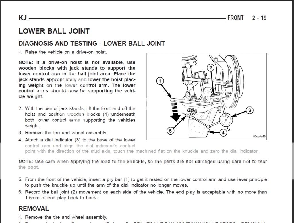

what is the procedure for checking ball joints on this rig?
U.S. Army Retired
 Post subject: Picture of words worth a thousand woords
PostPosted: Sun Aug 16, 2009 5:18 pm
Posts: 3553
Location: Aurora, IL
KJ FSM p 66
1.5mm = 0.059"
Personally, I would replace the ball joint sooner with less slop, 0.020" is enough slop for me.
Some may want to take the slop all the way to the Chrysler recommendation, after all it is a Free Country.
