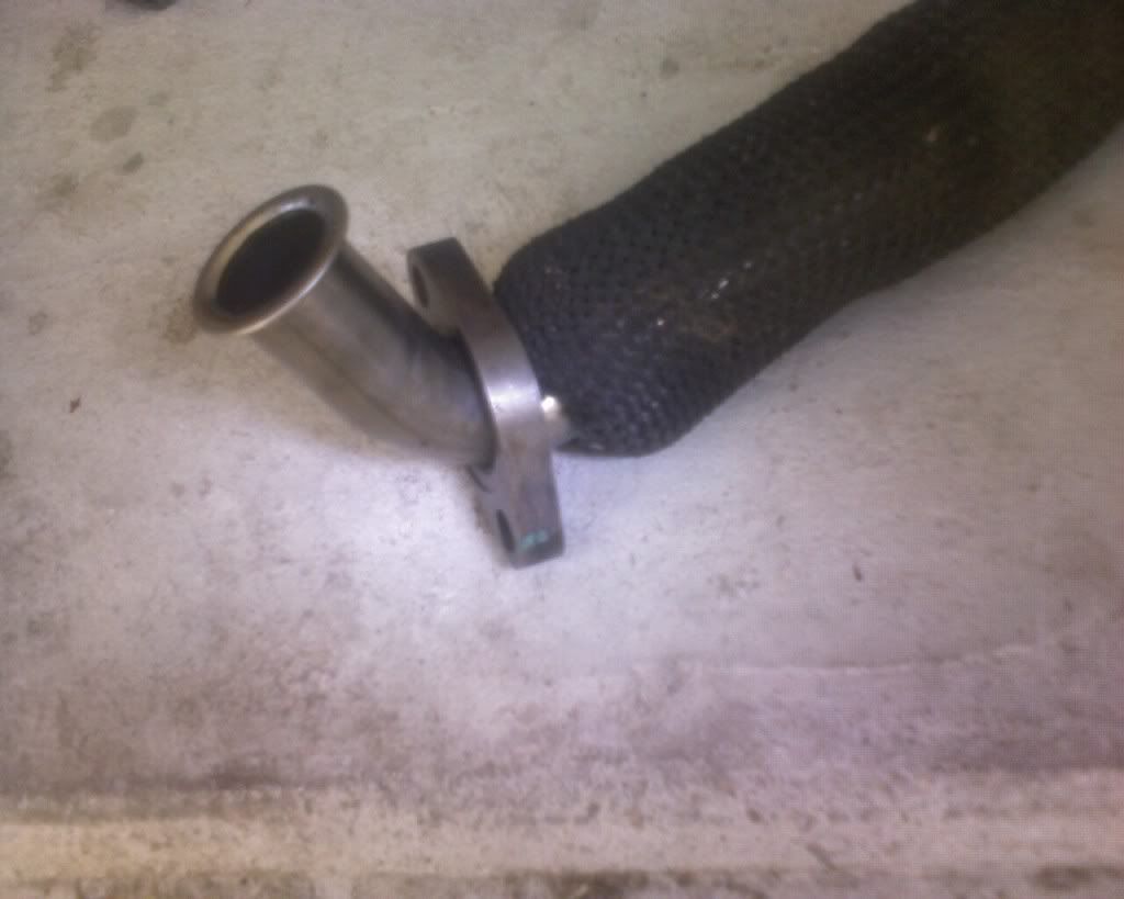

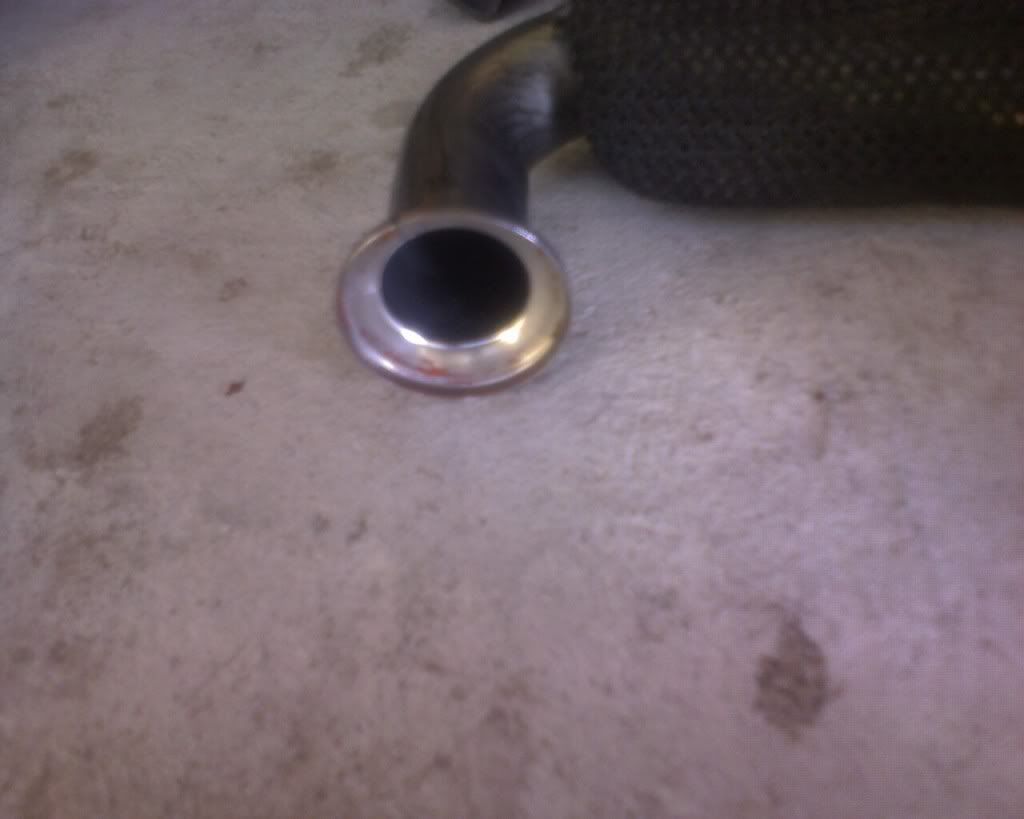

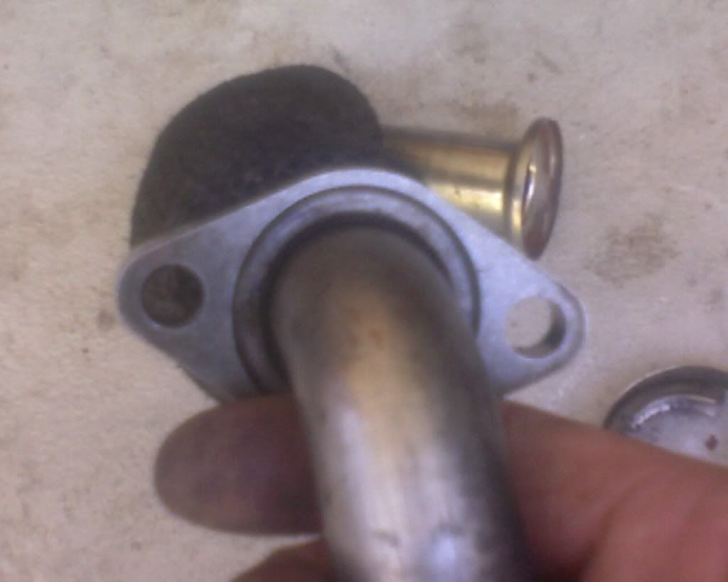

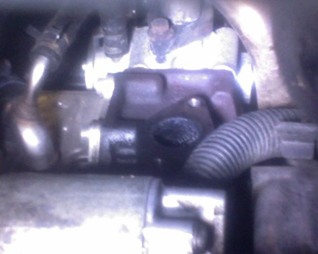

I just went through this little issue. At first glance I thought that I had a leaky rear main seal... Took a little time this weekend to see where the drip or two-a-night (that really annoyed my wife!) was coming from. This is the culprit, this is actually the after the cleaning-re-sealing job.
Same port with the pipe off. Bolts are 10mm
Under the intake, opposite side of the pipe, mount with the pipe off. No photo (except in the bottom rh of the last pic,) but the connector is a bit of a booger to get back together in the limited space. Can't remember exactly what they are called, but it's a hose clamp with two double section inner metal pieces to squeeze the pipe to its mount. 7mm's on the clamp.
First pic is the EGR side cleaned off, second is the intake side cleaned:
EGR side mounting flange, recess closeup.
Cleaned the pipe and engine mounting surfaces well, found that someone used a little high temp RTV on the intake side, I used a thin coat on both sides, re-assembled and after a long weekend of city driving, my driveway is NEW spot free!
I looked in my parts fiche for a new seal on the egr side, but it is not shown... no matter, this quick repair seems to be ok and only took about 45 min.
Hope this helps!
