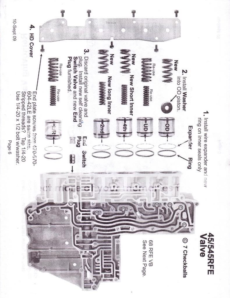

Call SunCoast and talk to Ron Wolverton and ask if he knows some ways to check with out a tear down.
To fix the pump all you need is the Transgo kit and install the pump valve and the springs. If the Transgo has been installed in your Valve body, there will be the thicker plate that does not look like it was stamped out of sheet metal.
Refer to the instruction page illustrations below to see the replacement pump valve and springs,along with the heavy duty plate.
When I tested my Experimental TCM that allows me to lock up in 5th high at 47MPH with the stock converter, I never got any chadder, I did every thing I could to make it chadder and it would not. When I put in the Transgo kit, my front pump valve was still OK. The problem with the front pump valve is that the wonder coating they put onto the aluminum for the valve seat fails and the valve leaks and then the lock up clutch chadders. Transgo and Sonax have hardened seats in their kits to fix the problem. Ask the guy you bought the CRD from if the shop put in a Transgo kit and if they put in all of the Transgo kit including the pump fix. Sorry about the rotated photos, they won't cooperate.
