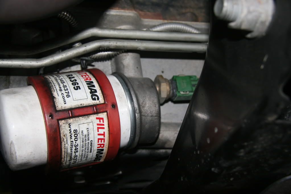

Not Amsoil, but here is where I mounted mine:
And here is a good, easy place to tap into for the supply, between the filter head and the green sensor:
