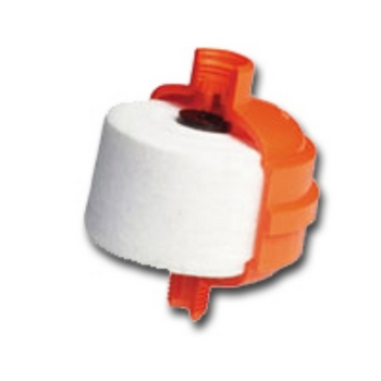

I have tested for 5000 miles a new setup and, here it is. Motor Guard corp. Model-D12-2 Disposable spray gun filter work very well. No bulky mounts or hose routing required just a couple of brass fittings to get to 3/4" hose size and, fit it in. I have checked the Map sensor prior to and, after the 5000 mile test and, still clean so nothing gets by but, air. I cannot seem to get the pictures to load up or I would send them also as this is a good idea and, cheap.
Nice idea.
But some of us collect a fair amount of oil as it blows by and a filter like this could plug up in a short time.

Two question on this filter:
How much oil would it hold before clogging?
What happens if they do clog?
If they're cheap enough and wouldn't clog up in less than ....say 5,000 miles, it could be easily changed as part of a normal oil change service. Thinking about it, if one could mount it so that free oil could drip back into the engine....might extend the life of the filter???

This is what Google thinks it is
http://www.denlorstools.com/home/dt1/page_26809_144/motor_guard_d_12_2_filter_air_paint_gun2.html
http://www.costplustools.com/Motor-Guard-D12-2-Disposable-Spray-Gun-Filter-2-Pack_p_3413.html
