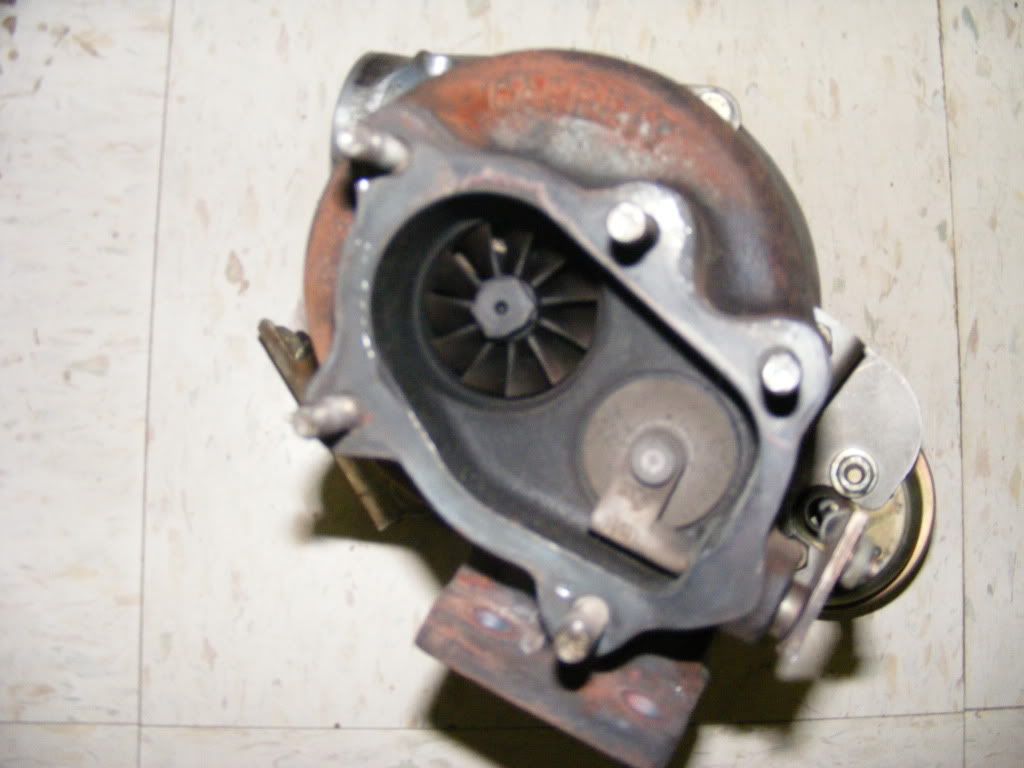

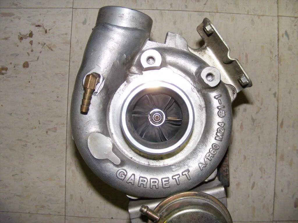

Hey guys. The new turbo design that I've been thinking of doing is now on its way to be reality. Just bought GT2560R Garrett. Custom turbo flange adapter is being built to turn the CRD manifold to a T3 flange. If the stock turbo shares the specifications of the GT2056 non vgt turbo on Garrett's website then the GT2560R would be a great step up ... (here's the link to Garretts turbo comparison)
http://www.turbobygarrett.com/turbobyga ... _sheet.htm
The GT2560R is a ball bearing turbo with a watercooled center. It is not a variable vane. I'm converting the stock wastegated GT25R's turbine side to a non wastegated T3 Flanged housing. (see link) I will have a external wastegate system to have easier control over the boost and not over speed the turbo.
http://cgi.ebay.com/ebaymotors/GARRETT- ... 5880ab9b43
I understand this is a project, but I like to try new things. I'm building a R/T version of this CRD Liberty. Airdog fuel system, bigger nozzles, EGR delete, Built Trans, Custom trans and engine tunes. Stock stance with 20" wheels off a Dodge Nitro R/T. Kinda a Street/Strip Diesel Jeep.
What is your guy's thoughts and concerns?

Theres modified vehicles out there that are dependable road vehicles. Like most of us CRD owners know that if a part breaks know one usually stocks it anyway.
I believe that this being a ball bearing, spool up would be faster than a jounal bearing. Ball bearings have proven themselves to be dependable turbo on other diesels or gassers. There might be lag compared to a variable but the right tuning can help with that. Being a automatic helps with spooling vs a stick.
I agree that the stock turbo is a poor performer and small. I've been monitoring how the Jeep performs either empty or towing going down the road. The Jeep is usually using all the power the engine puts out. It never shows signs of slowing down at any speed when empty, but the turbo is usually at full song to climb hills. This is where the fuel economy suffers. (Its like climbing hills with your foot on the floor) Why does a 1.9L in a 3200 lb car get 50mpg and a 2.8L in a 4600lb suv gets 22mpg? My dodge gets 20mpg in a 6500lb truck with a 5.9L. My guess is more horsepower usually doesn't mean less mpgs. If the engine can breath and work less then less fuel will be consumed. Yes aerodynamics play a part aswell.
I'm a performance guy. I like to tinker I guess. It just sucks that there is very very few options for us U.S. CRD owners. I've talked to Kieth at GDP. He is a great guy with great products. I'm building this Jeep to take to diesel events. Even if it runs 13s or 14s, it might spark interests in the aftermarket, plus it will be neat to see a Jeep perform on a track. Only time will tell.

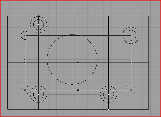

Here's the redering of the new adapter. Stock CRD flange to T3 flange

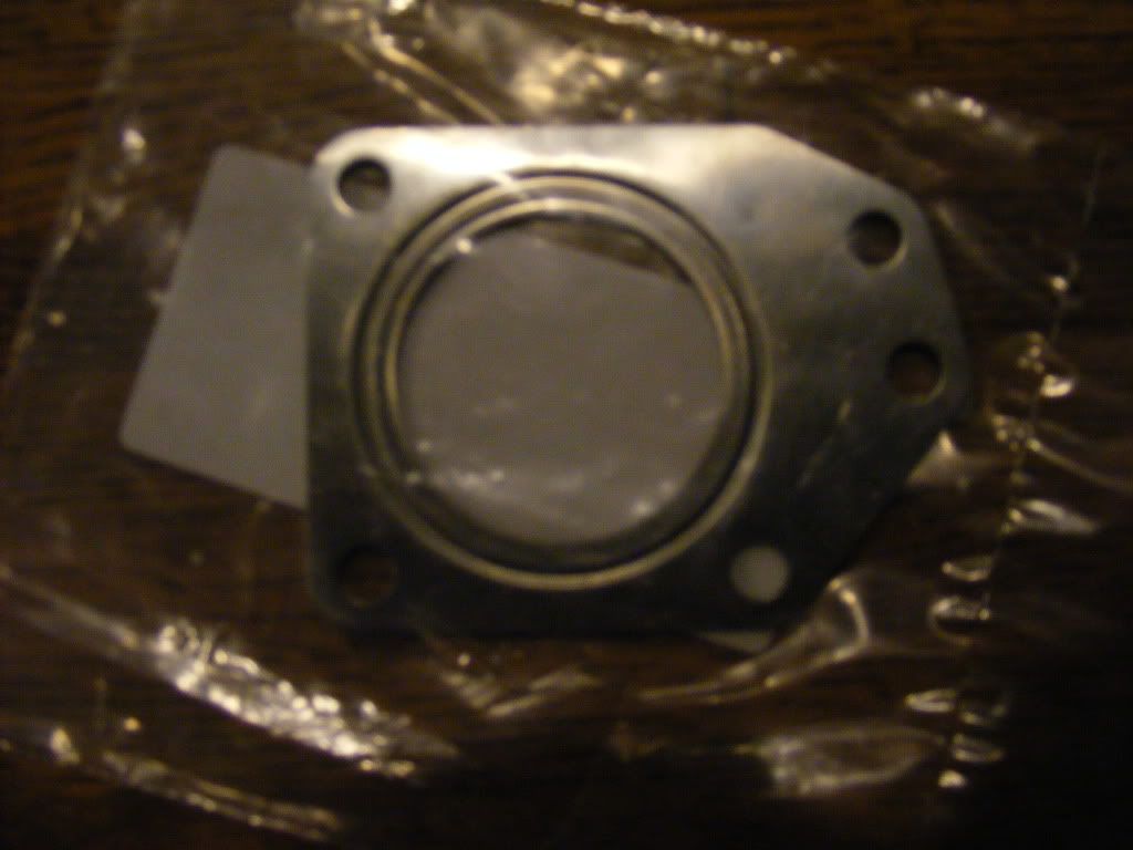

Turbo arrived today... :BANANA: :BANANA: :BANANA:
GT2560R
Stock CRD flange gasket
