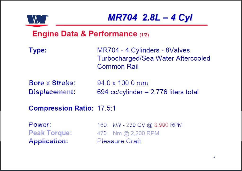

 Post subject: Looks like a dropped valve.
PostPosted: Fri Oct 02, 2009 10:09 am
Posts: 3553
Location: Aurora, IL
Is that rust in the #1 cylinder? If so you may want to change out the #1 Sleeve along with the #2 piston and sleeve.
Your photos do not have high enough resolution to determine if the engine was over heated. look at the cylinder walls and see if they look like white color cast steel and do not have a brown toast color. I suspect the brown color I saw was a reflection from something else.
As far as the Cylinder Head goes, replacement is best, but there may be a machine shop who can work wonders. As a rule, they will not take on the job if they can't do it.
As a rule of thumb, if the cylinder walls turn a brown toast color, the engine has been over heated to the point that the rings are annealed and will not properly seal. Since you will at least be replacing the rings on three of the cylinders and the piston on #2, I am only putting this info in for future reference.
One thing I would take into consideration is how much they get out of the VM 2.8 for Marine applications where they do not have the limitation of a radiator cooling capacity. This figure would let you know the limitations of the structural parts of the engine. Ya, you can fudge the Marine HP a little, but be weary if it is not at least 50% to 75% more than our vehicle rating.
Perkins has had some 6L engines that were rated 120HP industrial and 300HP Marine, same long block and head.

 Post subject: Marine specs as sold in US
PostPosted: Fri Oct 02, 2009 3:11 pm
Posts: 3553
I calculated the Horse Power at 228, so now we know where VM draws the line.

 Post subject: Re: Marine specs as sold in US
PostPosted: Fri Oct 02, 2009 11:19 pm
Joined: Tue Mar 18, 2008 9:34 pm
Posts: 346
Location: Sanford, MI
...not trying to pick a fight here...just asking out of curiosity.... Would that horsepower rating for the 8-valve marine engine translate to a true baseline for our 16-valve engines?
PostPosted: Sat Oct 03, 2009 11:00 am
Posts: 3553
kdlewis1975 wrote:
16 valve will rev up faster and have a little more with a flatter torque curve than an eight valve.
Fast revs out of a Marine engine is of no use since they run a prop.
Same block, crank, and rods, same structural limitations, that is my point.
VM like any company will employ a safety/service factor to limit failures.
When some one wants to go for the max, they are taking the risk and are flirting with destructive testing.
With the 228 HP Marine rating, we all know that we could go up to that point and perhaps a little beyond without worrying about having our engine fly apart from pure horse power out put.
I would never attempt it with out a complement of gauges.
Of course, there are a lot of DUMB@$$ stunts that will destroy even a stock engine, that idiots reserve the right to do.
