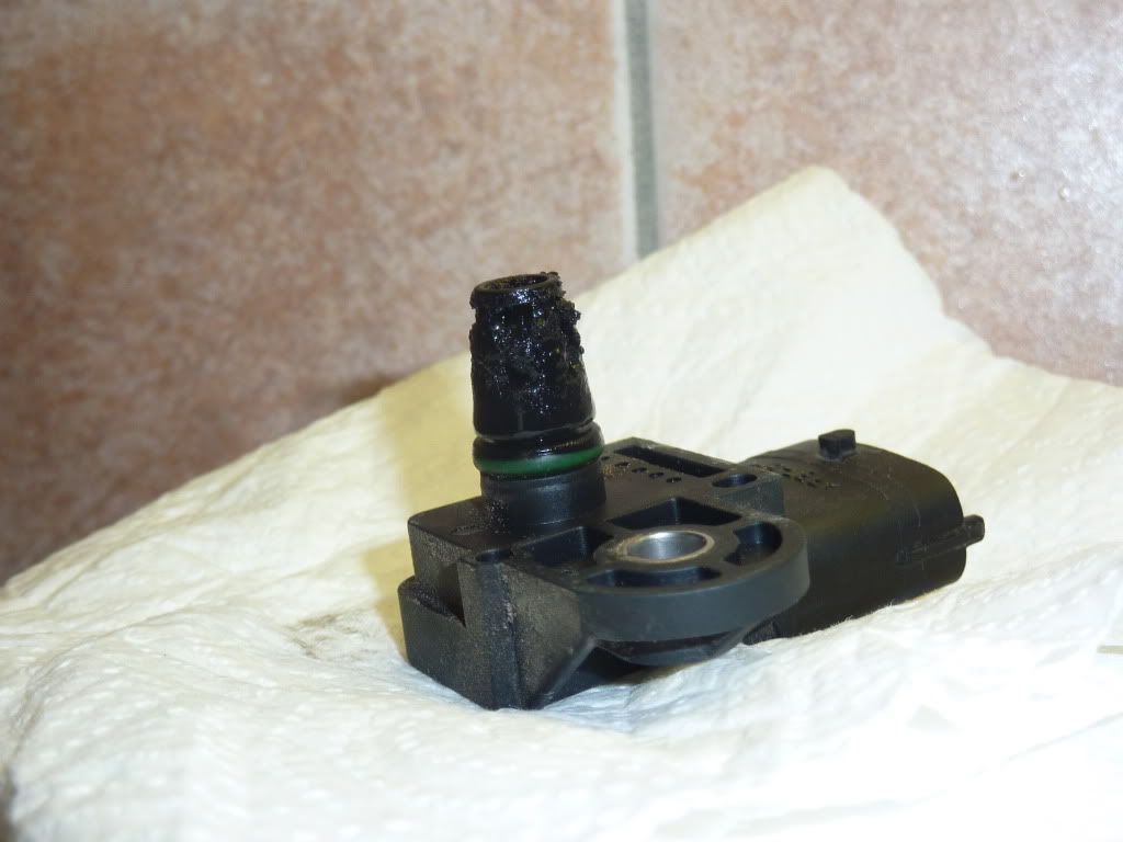

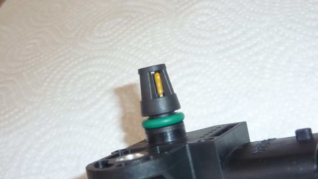

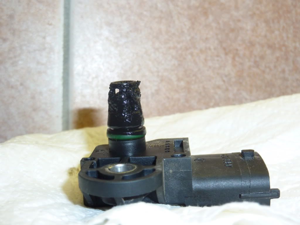

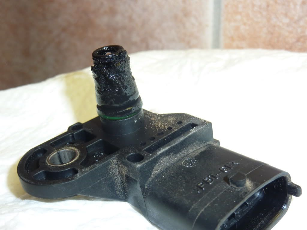

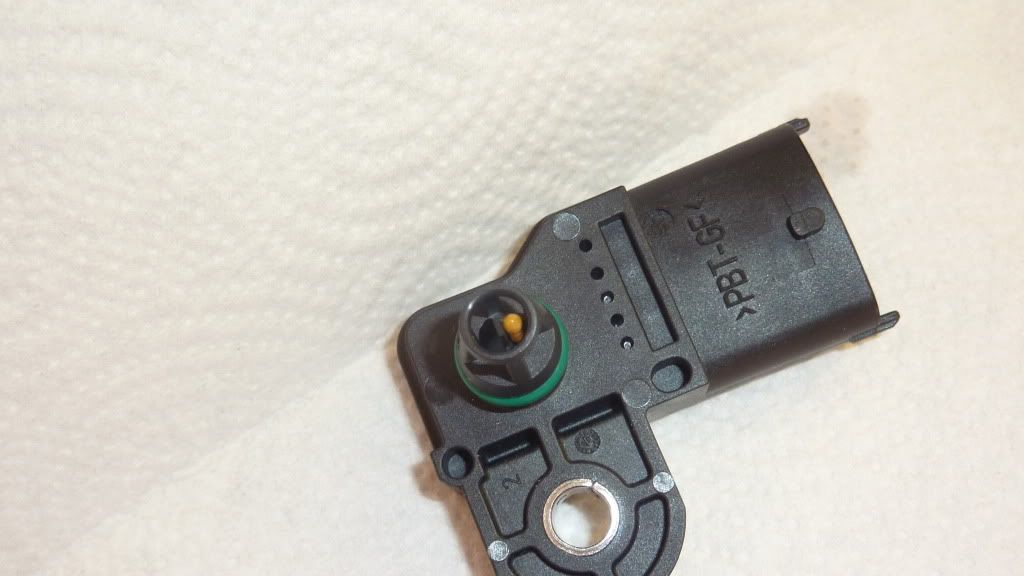

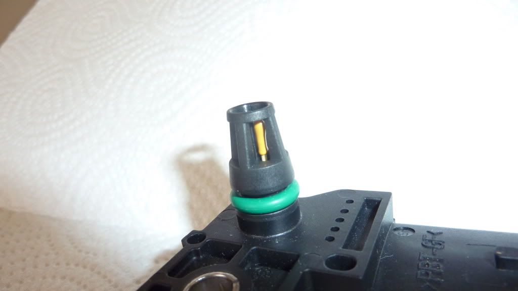

I am just coming out of loss of power but i had an OBD: P0299-BOOST PRESSURE SENSOR POSITIVE DEVIATION. replaced the MAP-MAF and hoses.
Finally it was a vaccum line, here is the thread: viewtopic.php?f=5&t=61240
I cleaned mine with WD40, seemed to work well. but i used a tooth brush, and i would not recomment this. but a paint brush instead, this should avoid shaking the yellow stuffs to much.
As per the look of the MAP, here are some pics of before and new:
After 90'000 miles:
New:
Good luck !
Hope this helps !
