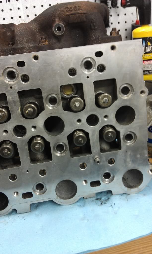

This was kind of the part I was hoping to get by buying a used head. We removed the head yesterday and its at the shop today to see if it is warped. The head looks great though my dad found a smoking gun right off the bat. When he flipped the head upside down a little freeze plug fell out. So we assume that this is what caused the water to enter the cylinders. Not sure why the freeze plug fell out. But it seems that it did not have a blown head gasket after all. All we think we are going to need are the rocker arms and lifters, not a whole cylinder head.

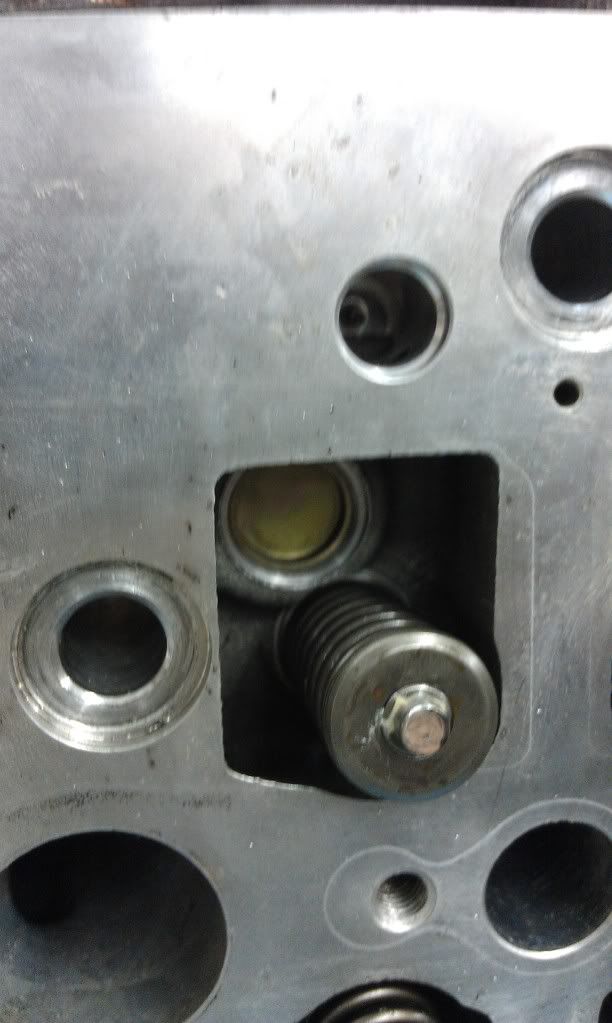

Is there a possibility that you could point out which plug it was that fell out and where it was located on the cylinder head with some photos?

This is the freeze plug that fell out. Still do not know the reason since I didn't own the vehicle when it happened. I'm not sure what the vehicle went through.

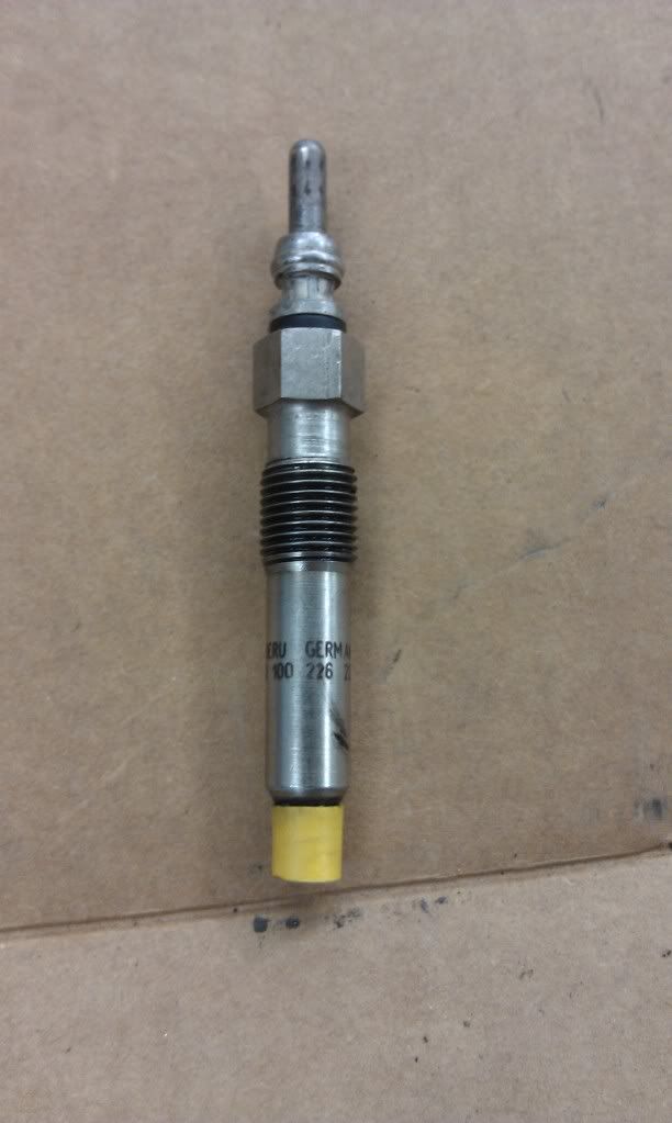

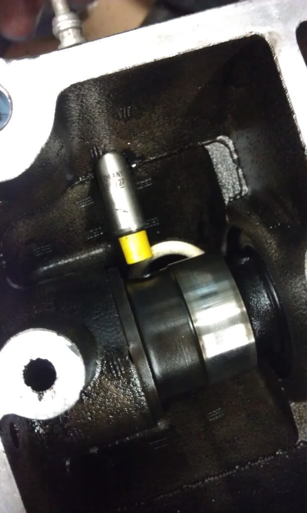

Ended up making my own camshaft alignment pins. I used glow plugs off a 2001 TDI jetta as you can see in the pictures.
