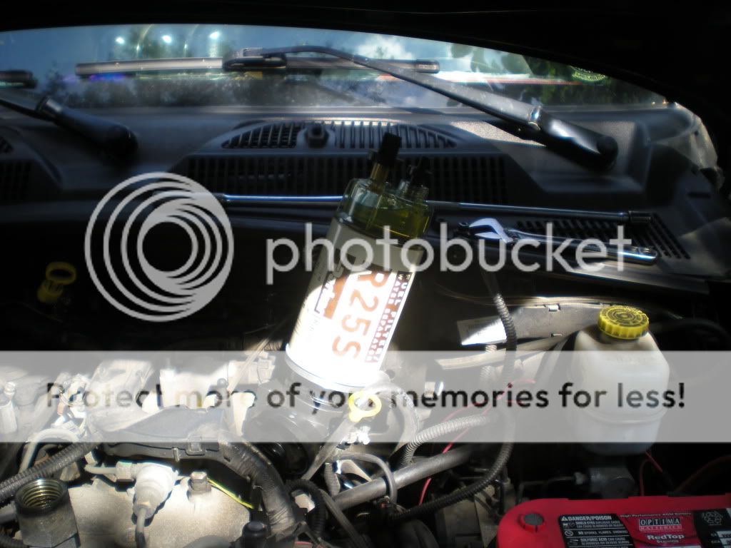

Another option to consider is forum member gmctd's top load Cummins fuel head:
 Post subject: Re: Replacement Fuel Head Options
PostPosted: Sun Oct 28, 2012 2:06 pm
Posts: 3553
Location: Aurora, IL
What I did and it works great. Sorry, I don't have time to make up any kits.

warp2diesel wrote:
What I did and it works great. Sorry, I don't have time to make up any kits. ]
That's some nice work on that adapter, how has it been working not loosening up at all? I like this idea, you can go right back to the (crappy made in china) factory filter if needed!
